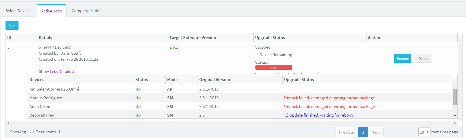

Hello. We had the SMs using 2.6.1-RC10 fail to upgrade using cnMaestro while 2.6 SMs upgraded fine. I attached a screenshot showing the failed SMs.
Any ideas? Thanks
- epmp fail.png (47.6 KB)
Any ideas? Thanks
After the cnMaestro upgrade failed, I downloaded the non-GPS 2.6.1 file and tried uploading it directly to two of the SMs that failed. I've attached here two pictures of the error message received after trying a software upgade directly to the radios.
These are Force 200 2.4ghz radios.
Any help is appreciated. Thanks
Hi,
We tried same scenario in our test lab and it worked fine. Could you please reboot these SMs and try upgrading them again from cnMaestro.
Thanks,
Ajay
We had the same issue on 4 units. After a reboot we were able to upgrade them successfully.
