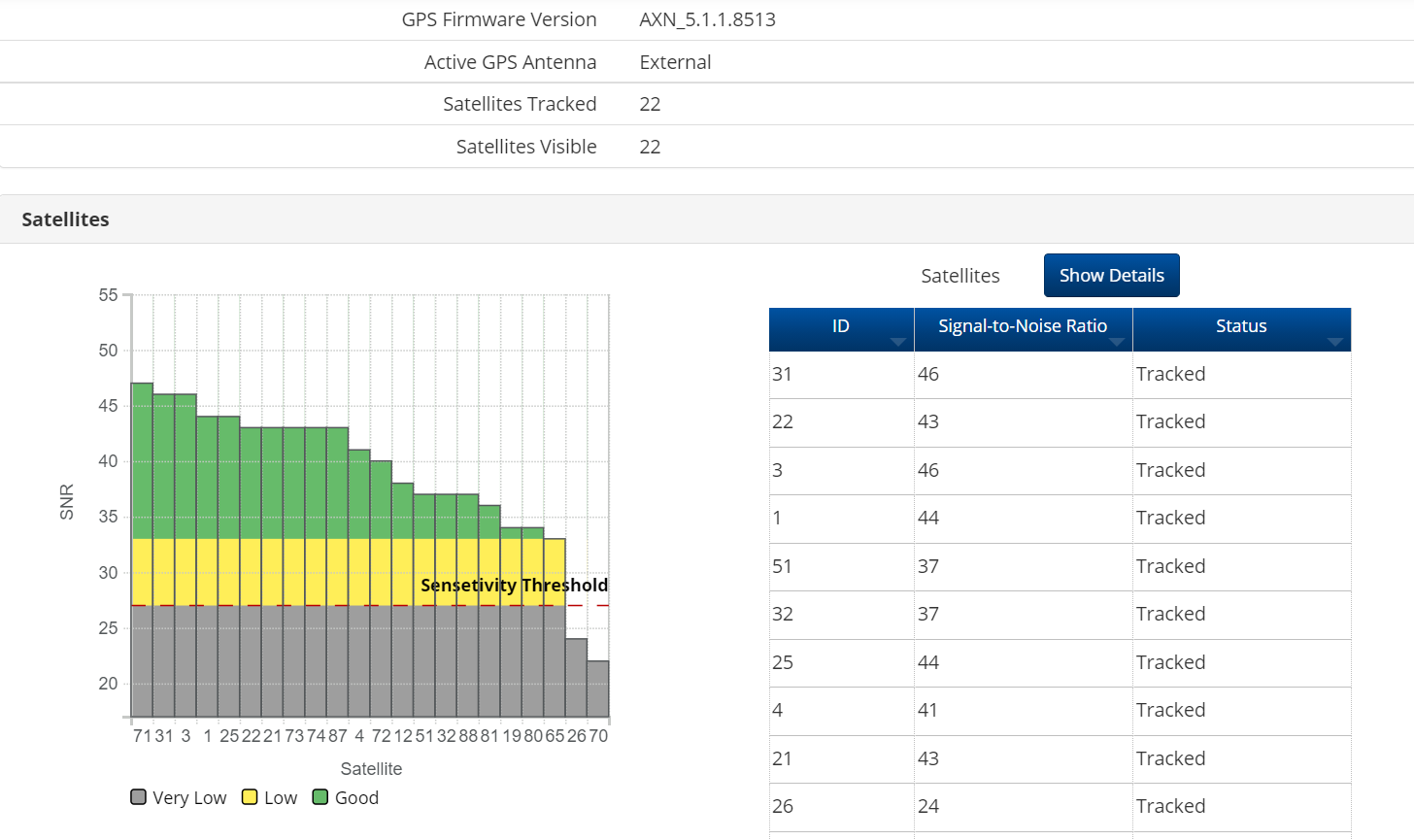

Hi all, running 4.6.1RC27 on a epmp 3000L and I see now there is a handy graph showing the gps satellites and the SNR, what do you think about this…
As per a post by Fedor this is passable but is it really adequate? The radio is not modulating the best.

Based on the pic I provided what can I do to increase the SNR of the satellites… Install pucks instead of using internal? I have a couple epmp 3000 with external pucks that are tracking over 20 satellites but the SNR is poor.
Here are two epmp 3000 radios, one facing east … has great snr to satellites and the other, west facing, does not…
East facing…
West facing…

It would be very interesting to see your West facing 3000 (only 4 yellow sat signals) and with no changes, other than connecting an external GPS puck, and positioning the puck so it’s clear to the southern sky.
I think if you contact Cambium Support via a Support Ticket, they may send you some of the latest/greatest pucks (I’m not sure what the policy is) but that AP would be a great test I think.
Those 4 pics are epmp 3000 all with pucks… top of tower with no obstructions to sky. I am wondering if the west one is possibly disrupting the sync… these 4 are using frequency reuse with their respected partner.
Well the West one certainly has some issue with receiving Satellite GPS signals. So, either the GPS puck is broken, or the GPS puck is mounted where it’s blocked, or there’s a connector loose or broken or something. It’s obviously not getting anywhere near enough GPS Satellite signal.
As for whether or not that’s disrupting sync – if that’s losing GPS Lock, then the AP will keep broadcasting for whatever your Holdoff Time is set to. The clock will drift, without GPS to keep them all regulated. So, right away, a loss of GPS isn’t critical, but depending how long your ‘Synchronization Holdoff Time’ is set to… that AP’s clock will drift more and more - and if you’re using frequency reuse, then YES, that can affect the other ones for sure.
