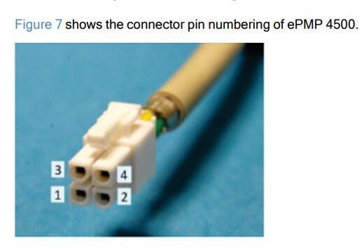

Can anyone confirm the Part Number for the DC Connector PN
Going through the Planning & Installation guide, LINKPlanner, Datasheets. I have found no reference Part Number
Apologies for the delay in response.
For the ePMP 4500 integrated access point, you can use the following DC power connector kits:
N000000L123A - DC Power Connector Kit 18AWG, packet of 10
N000000L124A - DC Power Connector Kit 16AWG, packet of 10
