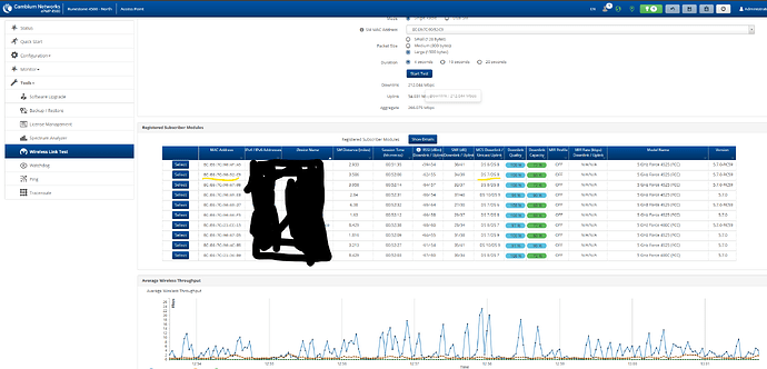

20mhz seems to work ok and you get really close to what the AX chart suggests you will per modulation level. 40mhz best case scenario, you end up getting around 60% of what the chart suggests and 80mhz is closer to the 50% mark.
For instance, the picture below is for a 4500, which is slightly worse off than the 4600. Its all about the same ballpark though. The picture is a 40mhz carrier.
Your sentiment regarding taking the top users of Airmax and putting them on the 4600, i would agree with. As long as you keep your client counts really low, then you should be fine. For instance the picture below is of a 4500L and a 4500 with less clients but the exact same modulation levels.
