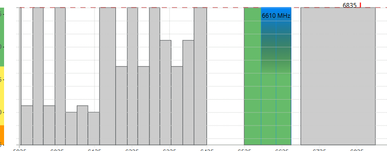

Working like a charm. however, how does the power graph ( an example screenshotted below) work? what do the different bars represent and how do we know if a set of spectrum is being used or not?
In addition, if the unit loses power, how long until the AFC reassigns the allotted power output?
Grey bars represent usable space (although some are not large enough for a 20MHz carrier). The taller the grey bar, the higher the allowed EIRP (up to 36dBm). If your carrier overlaps multiple grey bars, the AFC will reduce EIRP to that of the lowest bar.
White spaces represent reserved or adjacent incumbent licensed operations.
AFC users do not register in the AFC and are not afforded any protections from other AFC users.
AFC users are not afforded any protections. Anyone can use an AFC compliant radio to operate in 6GHz.
Yes, it will not show even another 6Ghz you are running under AFC. You will have to utilize the spectrum analyzer to determine what is the best amongst the selection shown by the AFC.
