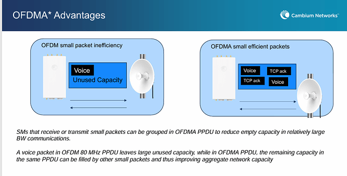

  1. Small packet grouping in the OFDMA PPDU to improve efficiency and capacity.

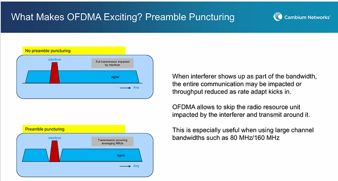

  1. Preamble Puncturing - This technique can boost throughput in crowded environments where narrow-band interference is common, preventing, for instance, a 20 MHz neighbor-network signal from killing a 160 MHz link.
Are both those features currenlty active in the latest FW? Maybe I misunderstand the preamble puncturing, but I know I have had many times where 40mhz of interference on 1/2 of an 80mhz channel (mostly AP side) has killed performance so much I have had to change to a smaller channel using Asymetrical UL.

The answer is yes, at its core OFDMA is being used, and from what I understand, it’s a tool box of features, and there are some features that are not currently enabled…. like preamble puncturing isn’t enabled.
