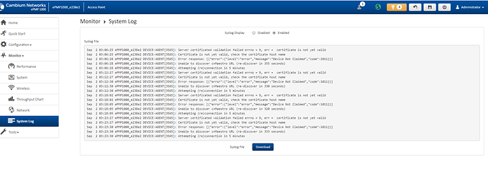

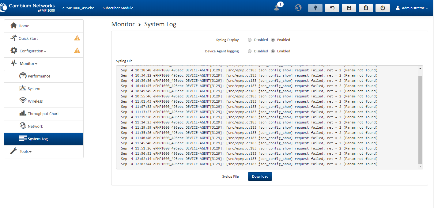

One more thing as I try to ferret out why I keep losing connection. I noticed my SM “ethernet status” reports “down.” But while it’s “down” I still have connection through the remote bridge (which has the ethernet cable from the SM plugged into it. I’ve uploaded both AP and SM logs, are these meaningful in diagnosing this issue?)
