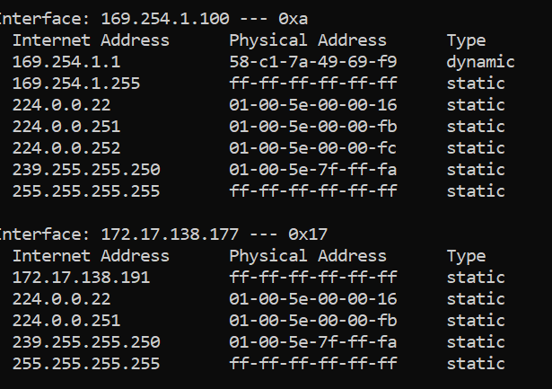

Firstly thank you so much for your responses, I can’t get anyone to physically visit so this is really my only hope. Now, I plugged the line to the POE that ultimately feeds the AP and manually set my IP on my laptop to 169.254.1.100. When I tried to connect, received “169.254.1.1 too long to respond.” Also did the same for Olympe’s suggested IP’s after manually changing my laptop’s IP to 192.168.0.33 and had the same responses. I’ve posted some screen shots, I can’t help but think I’m missing something obvious. These radios came right out of the box and I haven’t done anything to them. Any suggestions are very appreciated.
change your default gateway to 169.254.1.1 or leave it blank
Thanks Cheree, I tried both but still no response from 169.254.1.1 although I see it on the network from the “cmd” interface (pictured above). I also tried 10.1.1.254 as per the ePMP user guide (after manually setting my laptops IP to this range) and still no response.

If you are trying to get the laptop and the radio to communicate on 169.254.x.x addresses, then the default gateway of 192.168.0.1 may mess things up for you. For me, I also like to turn off the WiFi adapter on the laptop, just to make sure it’s IP settings aren’t screwing anything up.
Then, from the Command Prompt, you should be able to ping 169.254.1.1
So for me, I like to first open a command prompt, and I like to have a ‘ping 169.254.1.1 -t’ continuous ping going, and then as I plug and unplug things - or as I change IP or Netmask or Gateway settings…I can see if that’s working or not working.
NOW - if your IP’s are all correct, you should be able to ping it. If you can ping it, but can’t get at it via the web interface, then the problem might lie in a browser cache issue, or in one of the Cambium firmware bugs - which basically require clearing cache/cookies/etc for that IP.

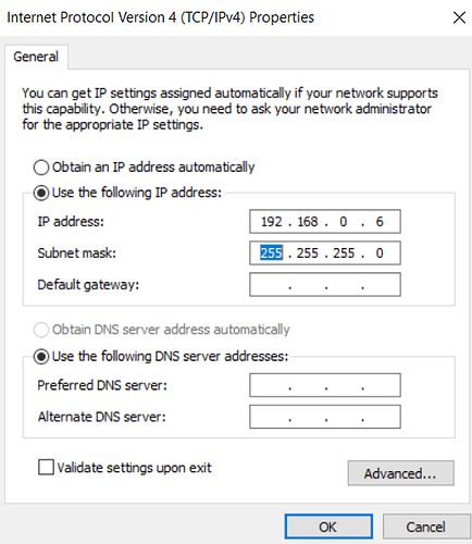

Hello Jean Michel,
set this IP address on your laptop as below:
You do not need to add the default gateway. Then, try to ping the ePMP AP on 192.168.0.1 and Subscriber Module on 192.168.0.2. Do not use 169.254.1.1/16. It is the default IP address for the PMP 450 series radios. You have the ePMP Series radio and they are accessible by default via 192.168.0.1/24 on ePMP Access Point and 192.168.0.2/24 on ePMP Subscriber Module.

Thanks again, followed instructions and pinged 192.168.0.1 and .2 with cable from AP tied into laptop. Both returned “Destination host unreachable” with zero packet loss as shown in the snip. Also tried pinging up to .5 and had the same results. I will try from the SM side later.
