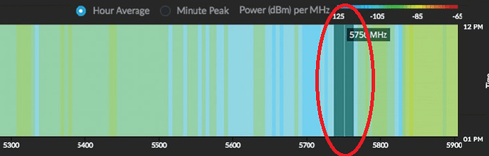

If say in a 20MHz channel, will you be able to hover over the results while displaying a shadow of where on the spectrum the 20MHz would be and display the Center Frequency on that area your hovering on?? Like in the image below (courtesy of a UBNT) Hope that make sense.
Would also be great to have the other Channel Width options as a tick box so you could look at them also.
Hi Chris,
Thank you for your input.
In first release we will not have that option implemented.
We will just highlight operational channels on the Spectrum Analyzer graph.
Video was captured when F300 was running in SM mode and it wasn’t associated with AP, that’s why operational channel is not highlighted on the video.
We already have scope of features for Spectrum Analyzer roadmap and your idea is also there.
Thank you.
