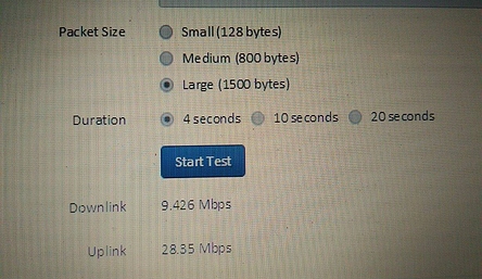

I have client with ePMP Force 110, is at Medan Indonesia. Is already connected for 8.7 miles. Througput result with mode ePTP Master is amazing 140 Mbps (Adaptive). But, now is to the trouble.
After times, about a week later. The ePMP Force 110 is down performance, just got about 70 ~ 90 Mbps.
Already tried to change any configuration, mode TDD and etc. But still, its not become better.

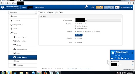

Some interference from another network may have developed on the channel you're using. Try launching the Spectrum Analyzer (under Tools in the ePMP GUI) and see if there is interference on your channel or those near it.
I have already tried to rescan, but it seems there is no problem with interference. And my client already re-tested with another RF Link its UBNT Rocket Dish 30 dBi (honestly its the previous one, and we changed to ePMP Force 110) its at the same channel frequency, its stable about 70 Mbps (aggregate).
At first I changed to ePMP Force 110 its amazing, Ive got 140 Mbps (aggregate). But after week later, its down to 70 ~ 90 Mbps, and at night its down more to 30 ~ 40 Mbps.
* Here is the result when I first time connect it.
