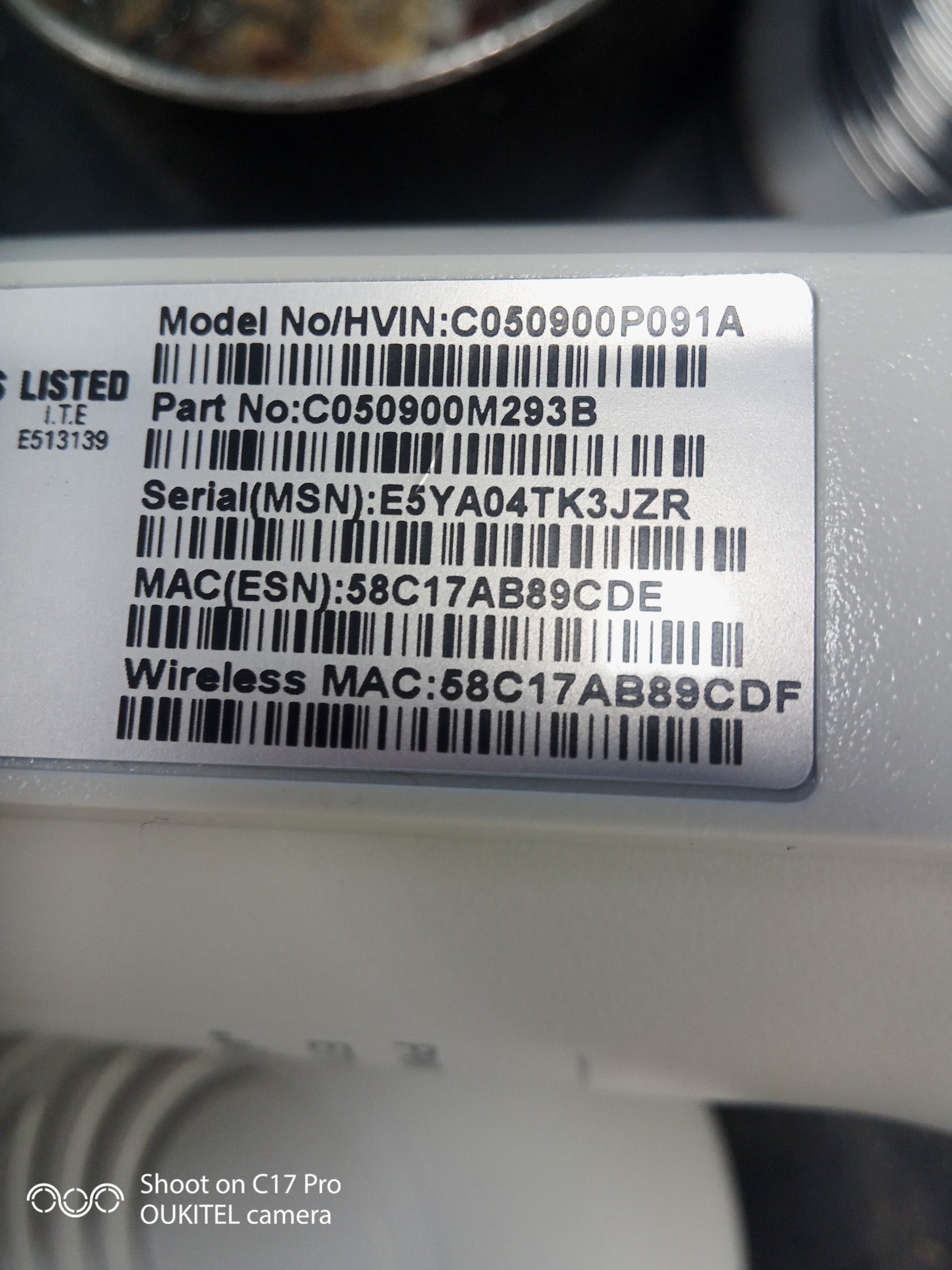

Whatever firmware version I try to upgrade, I get a message that the SKU is not supported for that firmware.
Need help.

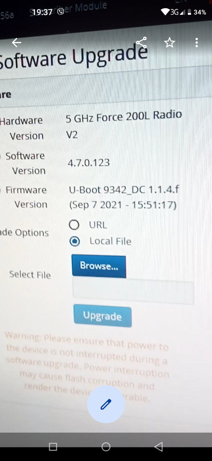

Have you tried pushing firmware to it with cnMaestro? Do you get the same error? Sometimes we find cnMaestro able to upgrade a radio which doesn’t want to upload firmware directly. ![]()
I haven’t tried it with CN Maestro, the device is new and before going into the network I intended to upgrade it due to “Reconnect Primary AP”
Regards
Hi @zica49 ,
please confirm you are using ePMP-NonGPS_Synced FW!
Wich versions did you try?
Of course, if I choose “non GPS”, the version he tried himself was 4.7.1 and it didn’t work. It starts to stop and I get a report that the SKU is not supported.
Now tried with version 4.8.1 everything went as it should.
