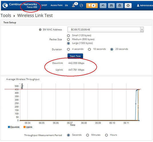

This is a quick test of a Force 425 ~~ Force 425 PTP link in 40Mhz mode, and about 450 Mbit in 40Mhz. It scales up and down pretty good, so a bit more than half that in 20 Mhz mode, and a bit less than twice that in 80 Mhz mode.
ninedd,
Just curious, what is the distance of this link?
This one is about 1.3 KM in the city, and is the F425 with it’s 25 dB antenna.

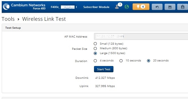

This is a 15KM link – Force400csm (connectorized) paired with 30 dBi antennas.
F400c_Beta_5.1.0.20_MTIK_BANDWIDTH_40MHZ_MAR_04_2021_002
I also set MikroTik to try to simulate typical real traffic, which was 30 Mbit uplink, and the rest as downlink, and ran it for a couple hours. It was typically doing about 389 down (plus 30 mbit bi-directionally) – so about 419 Mbit average aggregate
By the way, this link isn’t modulating perfectly yet either. I’ll try to tweak the aiming, and maybe upgrade this to 3’ dishes (34dBi) and see if I can get it to stay at ‘MCS11 5/6’ on both downlink and uplink.

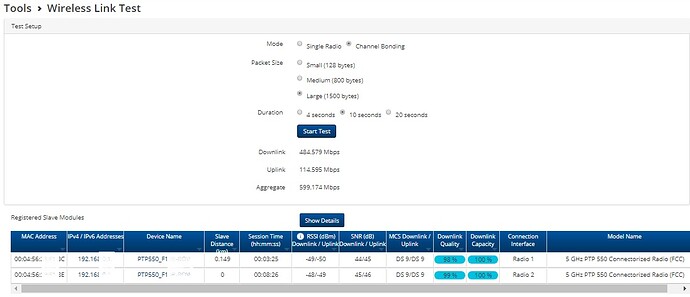

By the way DigitalMan2020 - here is one of our PTP550’s with dual radios bonded. About 600 Mbit aggregate. That’s pretty much what’s expected, since a Force300 can do about 300 Mbit, and a PTP550 is basically two of them bonded together. But, I could also bond 2x 80Mhz channels and get 1,200 Mbit, or I could bond a 40Mhz and a 20Mhz channel and get about 450 Mbit throughput, or whatever my spectrum and needs require.

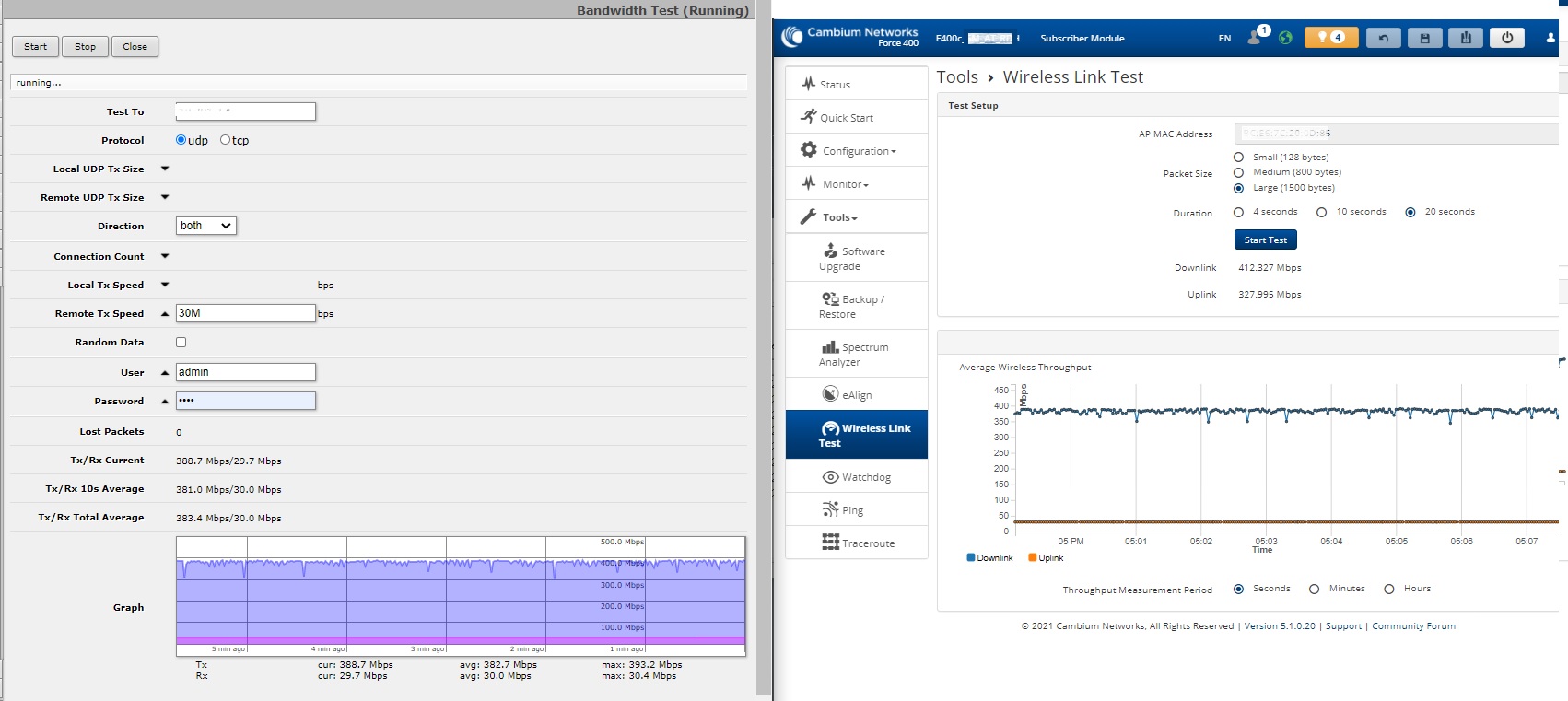

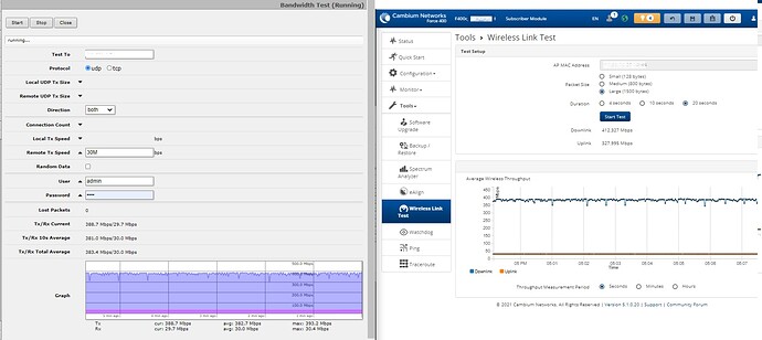

I have my Force400 link at 15 KM tuned in a bit better. I was previously only getting signal of -61 or so, but I did some more fine tune aiming, and got the signals up to -54, which then got the SNR to -30 (with is kinda our minimum normally).
So, this shows our link at ~ 15KM, in 40Mhz Channel width, with 30dBi dishes… aggregate signals -54 or -55 or so. This above images shows the built in tests - followed by tests by MikroTik. The built in tests are 410-415 either direction, and then the MikroTik tests I did UDP and TCP, which were all in the 390-430 Mbps range.

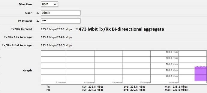

And finally - if I do a bi-directional test from MikroTik… it’s simultaneously TX 236Mbit and RX 237Mbit, for what looks like a Bi-Direction aggregate of 473 Mbit ← WOW (Can that be correct?)
