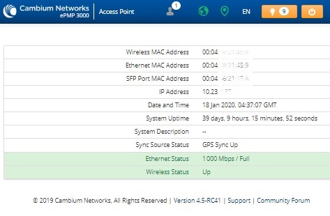

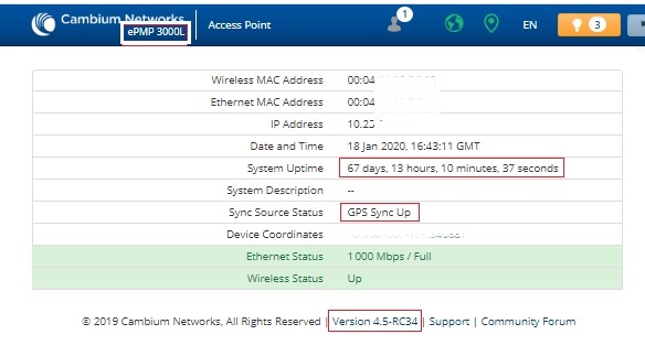

Regarding the 3000 & 3000L GPS instability which some people are reporting... I just thought I'd post that our 3000 & 3000L have been very stable.  I'm just about to upgrade a few AP's to the latest 4.5beta, and I thought I'd post these two images, showing GPS uptimes since our last upgrade/reboot.
39 Days since we rebooted this 3000 AP - with no GSP Issues in the last 39 days.
67 Days since we rebooted this 3000L AP - with no GSP Issues in the last 67 days.
These are both going to 4.5-RC54 today, so the uptime will get reset - but I thought I'd post that not everyone is having GPS weirdness, and that (at least for me) the GPS has been rock solid on our 3000 and 3000L APs.
