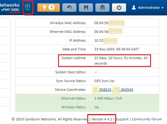

'm just about to upgrade some 3000L APs to 4.4.3, and I thought I'd post a screen shot of one of those 3000L's running 4.4.2 with 34 days of uptime, and with the GPS not missing a beat on any of them.
Just to be clear... I certainly don't doubt that the people reporting issues ARE really having issues... but I wanted to also point out that there are people (like me) who are having no GPS issues at all too. :)

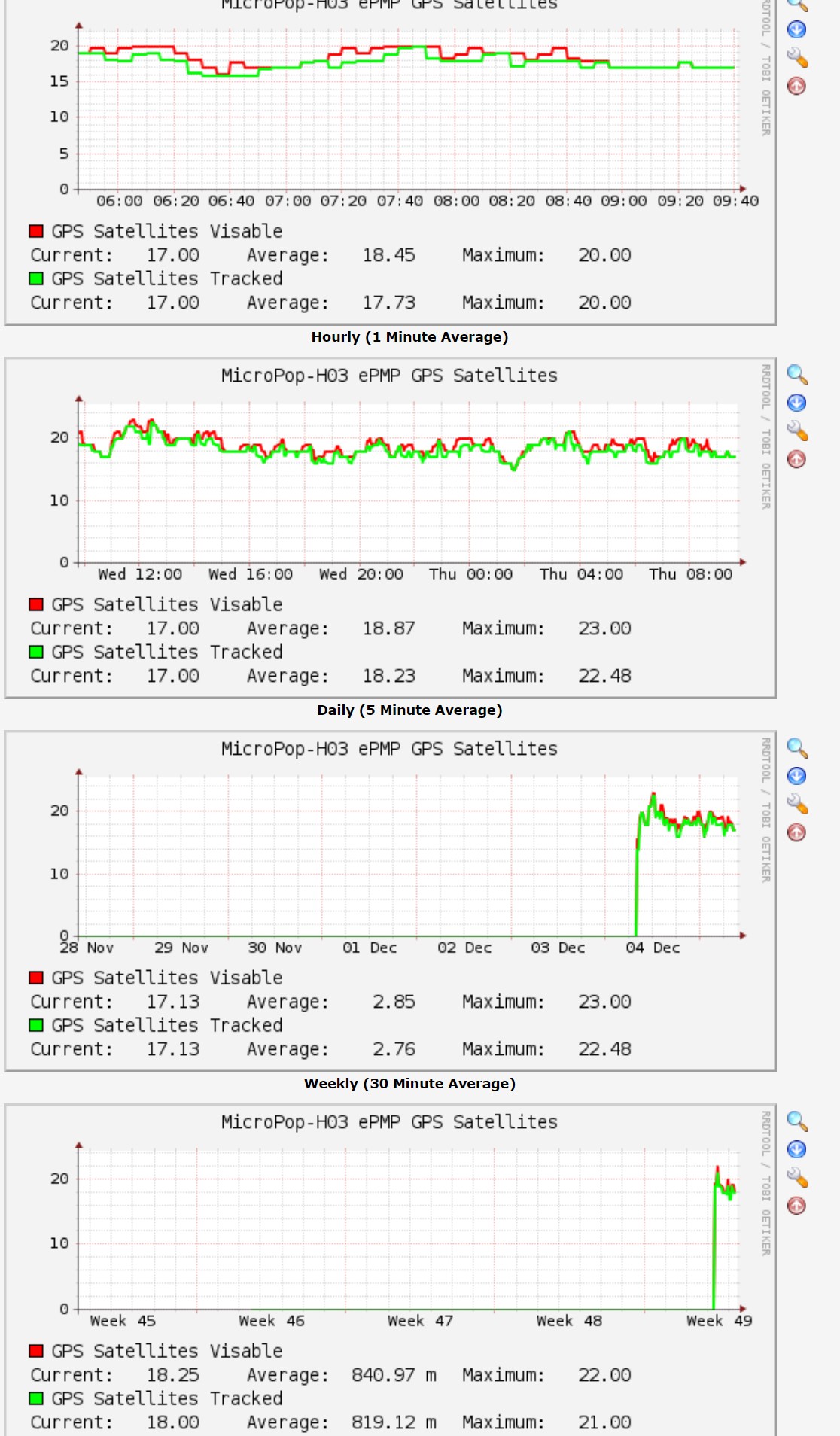

While I have several 3000's and 3000L's setting on the bench I've only messed with one of them so far, a 3000L. Just about a month ago I set up a 3000L and wasn't going to use the puck. On the bench, running v4.4.1 it could not see a single Sat but I assumed probably due to the concrete walls.  I put a puck on it but still no sats but again I figured maybe the walls. Everything else worked I took it to a small Micropop (10 clients) and swapped out the GPS 1000 AP that had been there for a year or so.
Normally we sync everything over power as I have not had good experiences with ePMP's onboard GPS. However on the Micropops I don't really have room in the cabinets and right now Sync isn't a big deal with them (it will become one eventually so I was really hoping they had their Sync issues worked out with the 3000's).
Swapped the 1000 who's sync had actually been working fine for over a year (with a puck) with the 3000L.  No sync, the 3000L can't see a single Sat.  So I've got the puck off the 1000 there , I attach it , still not a single Sat... I reboot, still no sats.   Oh well, not super important on this micropop and everyone is online and everything looks to be working and I have a huge list of other things I  need to be doing so I leave it.
Couple of days later, just out of curiosity I got a new puck and went out swapped them. Still not a single sat in view. That was a month ago and I haven't messed with that AP since.  This morning I decided that site would be ideal to test 4.4.3 on. After seeing your post I went and looked and what do you know it's tracking sats ! It's still running on self generated timing but it's seeing sats now !
But !  I went and looked at cacti to confirm that it didn't start seeing sats until I upgraded it this morning and ... well the graphs show that in the entire time since it was installed a month ago it had never seen a single Sat until, yesterday morning at 8:30am when it just suddenly started seeing 17 to 23 sats.   I didn't upgrade the software until this morning and I heven't touched that site in almost a month, no one touched it yesterday, there was no reboots, nothing to explain why it just suddenly started seeing sats yesterday morning...
So I won't be turning sync on until I have to and then I will not be using it's onboard stuff.

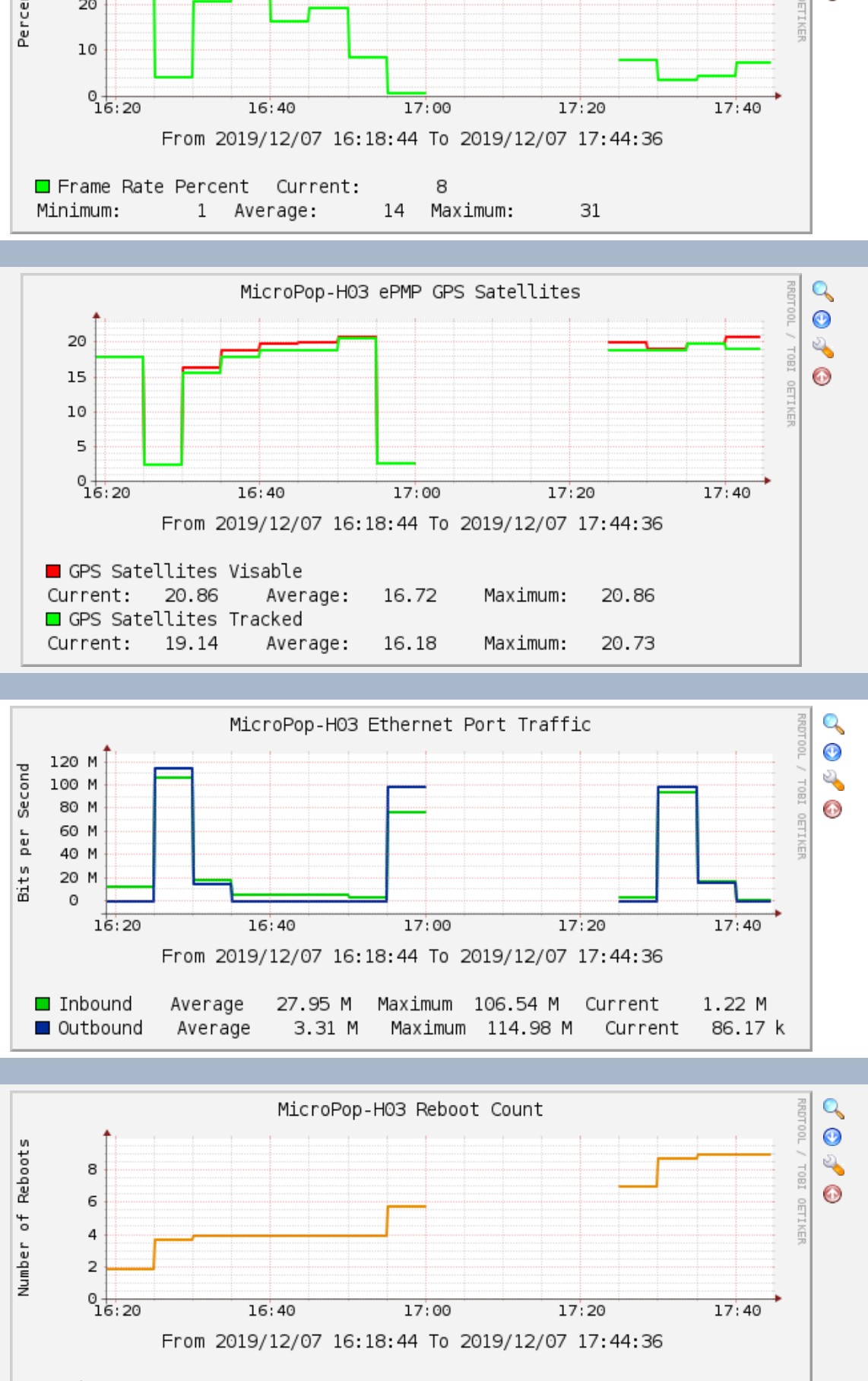

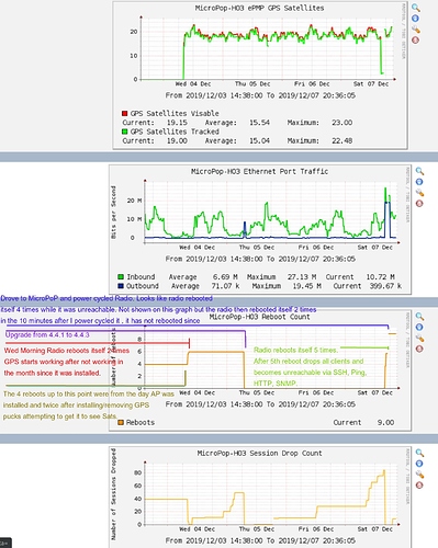

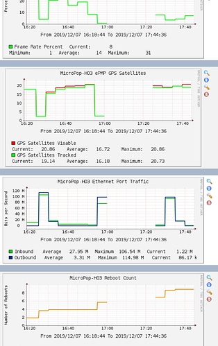

   I don't know if this is useful info or not but last night the AP in question appears to have rebooted it itself several times and then dropped all clients and stopped responding to HTTP, SSH, ICMP and SNMP.  When I arrived at the site to power cycle the radio all the lights on it were on and ethernet was flashing furiously. Power Cycling the radio fixed it but according to the graphs the radio rebooted itself at least twice in the 10 minutes or so after I power cycled it (that was a bit over 12 hours ago and it has not rebooted  since).  So this morning I looked at the graphs just out of curiosity.  I noticed that while we had not rebooted the radio the day the GPS started seeing Sats , it had rebooted itself several time.  It also rebooted itself a few times just before it went dark last night.
Also note in the 2nd pic I attached. I zoomed in so the ethernet traffic is a 5 min average.  I don't know if this is symptom of the reboots or a glitch in the graphing but I've noticed this in/out spike that coincides with the radios rebooting themselves on customer radios when we had to replace them because they kept randomly rebooting.  I do not see these spikes when I reboot or power cycle the radio, only when the radios are randomly rebooting themselves. However there are also normally a huge number of ethernet port errors and there was none on this AP so maybe the spike is just a glitch in the graph caused by the reboot.
Edit: Note that I only have 4.4.3 in the primary bank and 4.4.1 is still in the secondary. So I am assuming the radio is getting completely booted each time before it reboots again else the firmware would have reverted to 4.4.1 ?
Also note the Force200 backhaul radio this AP is conected to has not rebooted during this time. This MicroPoP is a very simple setup : Force 200PTP --> epmp power supply <----> epmp power supply ---> ePMP 3000L ap.
Tonight this same AP dropped all 9 N clients and left the 1 AC (F300-16) client working. It remained this way for about an hour before I was made aware of the problem.   I rebooted the AP and all the N clients (and the AC) came back and it appears to be working for everyone again.

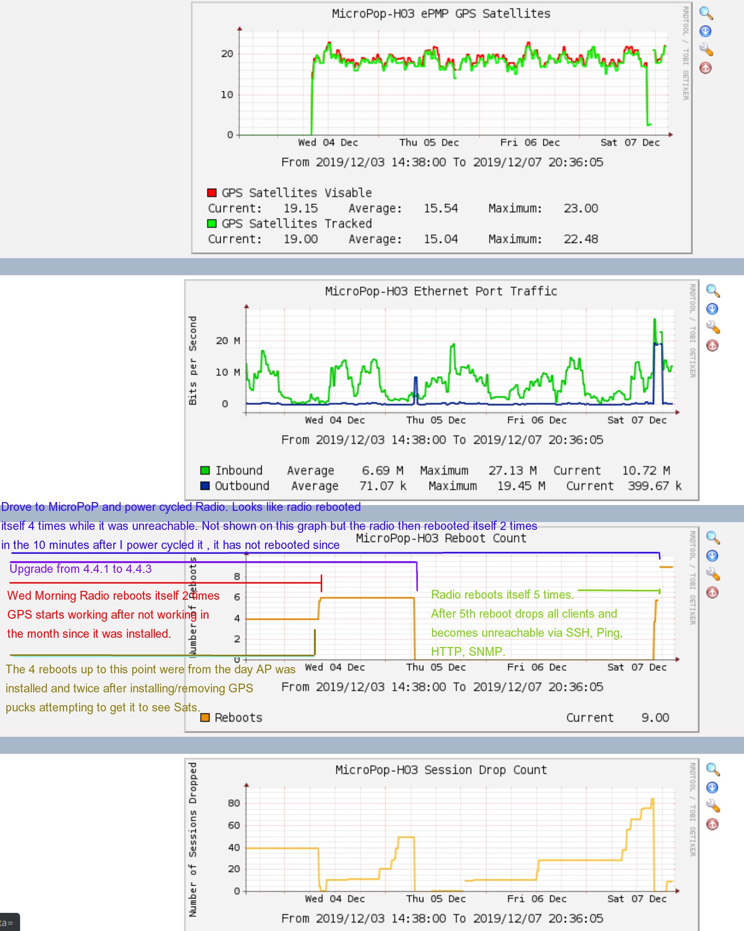

  Even though since upgrading to 4.4.3 I'm plagued with random AP reboots and client radios being randomly dropped it has not stopped seeing/tracking Sats... HOWEVER, this morning I thought I would turn Sync back on. So I set Sync Source back to GPS and set the Holdoff to 1600.  The graphing doesn't show that the radio ever loses sight of the sats , Monitor > GPS shows 18 to 21 Sats Visable/Tracked at all times BUT  the little "GPS" symbol at the top right of the GUI randomly turns red ever few minutes and may stay red for a few seconds or a few minutes and the status page will say "Sync Down" at the same time.  However the Monitor GPS page never shows it losing any tracked or visible Sats..   The randomly disconnected client radios aren't "all" being kicked like you would expect if the AP lost  sync and the random client radios being dropped do not appear to be related to the Radio saying it is losing Sync.
I'm rolling back the 4.4.3 firmware update on the clients and AP tonight but I'll leave Sync on to see what it does.

 The SA being enabled seems to be what caused all my issues.  It looks like about 3 days before I upgraded the AP to 4.4.3  I had turned the SA on. Looking at the graphs when I turned the SA on the CPU usage jumped from 5% average to 20% average , the next day the two mystery reboots that caused the radio to start showing it was seeing/tracking Sats, then the day after that I upgraded to 4.4.3 (not noticing the increased CPU usage, the two reboots or the radio now seeing sats) so I assumed 4.4.3 was the cause of the constant client drops and AP rebooting.
  I had already rolled the AP back to 4.4.1 and it didn't fix the problems  but once I disabled the SA the CPU usage went back to 5%' , no more AP reboots and no more clients dropping/reconnecting for more than two days now.
