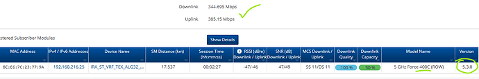

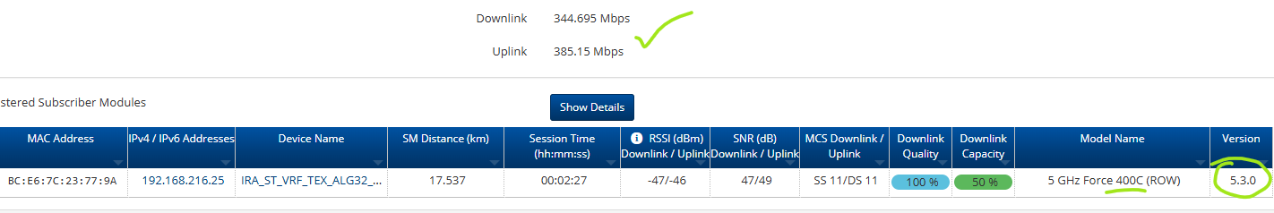

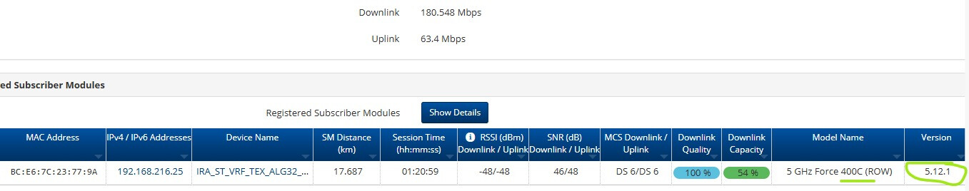

I’m running a Point-to-Point (PTP) link with Force 400C radios, and I’ve noticed that firmware version 5.3.0 performs significantly better than the latest 5.12.1 release. I am attaching the speed test screenshots to show the difference.
Hello @JORGE_CERON !
The difference is dramatic!
Have you chance to try with some natural traffic? I mean to isolate weather it is a performance issue or the wireless link test itself?
Could you PM me your techsupport files on 5.12.1? Or at lease one set on any FW.
Thank you!
