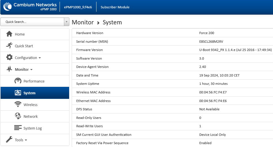

I attach the screenshots of the error on the switch port and the system of both antennas.

Anyway I went to the roof of the master antenna with my laptop and it connected correctly to 1G.
In any case I cleaned all the connectors on the roof and the situation improved. Now it also aligns to 1G on the new switch.

Today I also cleaned the slave connectors and the situation has stabilized. It aligns to 100 and seems stable (it hasn’t disconnected since I finished the work).
