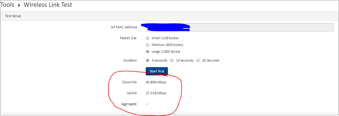

Yellow: Speed tesst to a CPE 21.14 Miles from AP
Results:
40.7 Downlink
31.9 Uplink

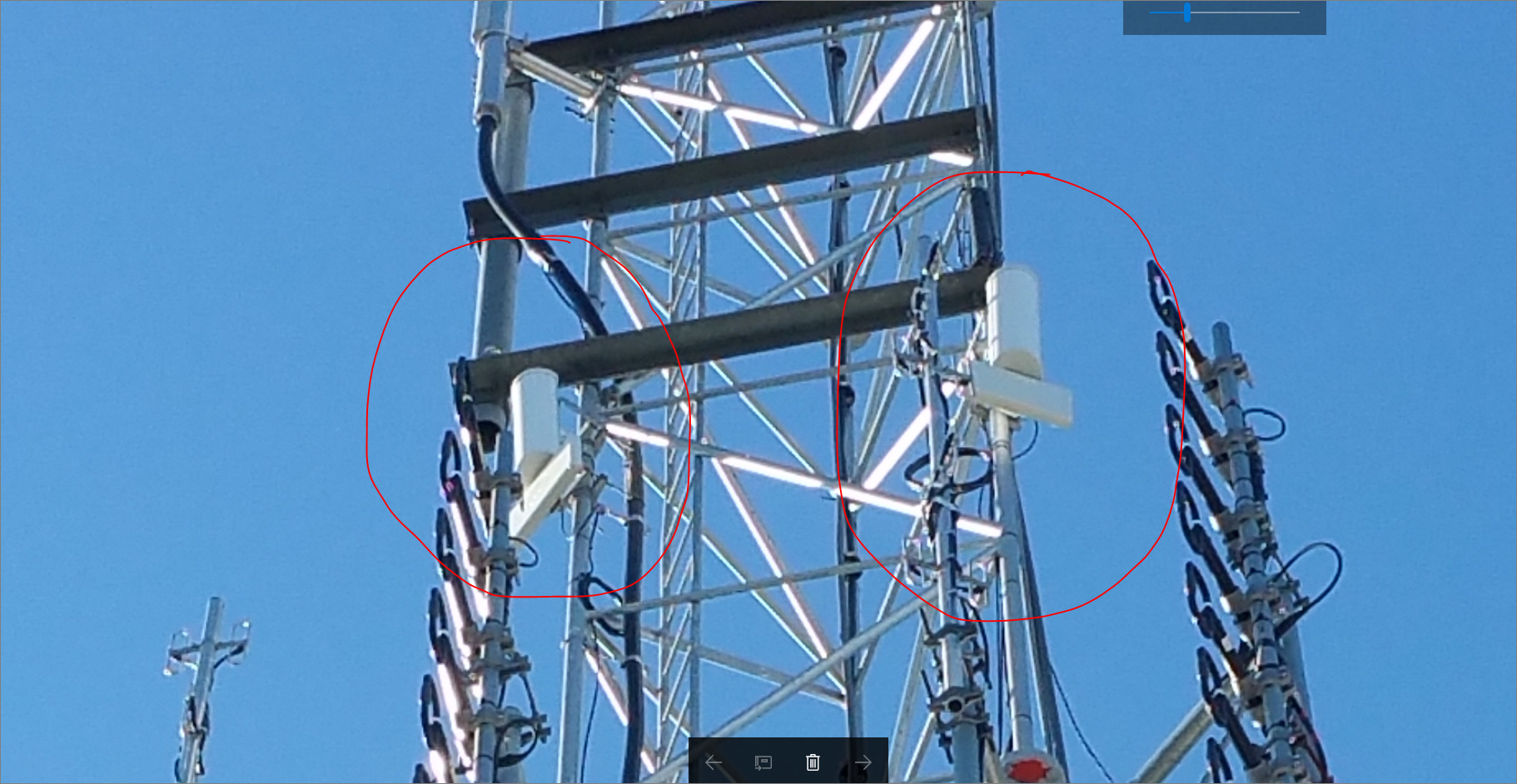

AP
ePMP2000 with smart panel

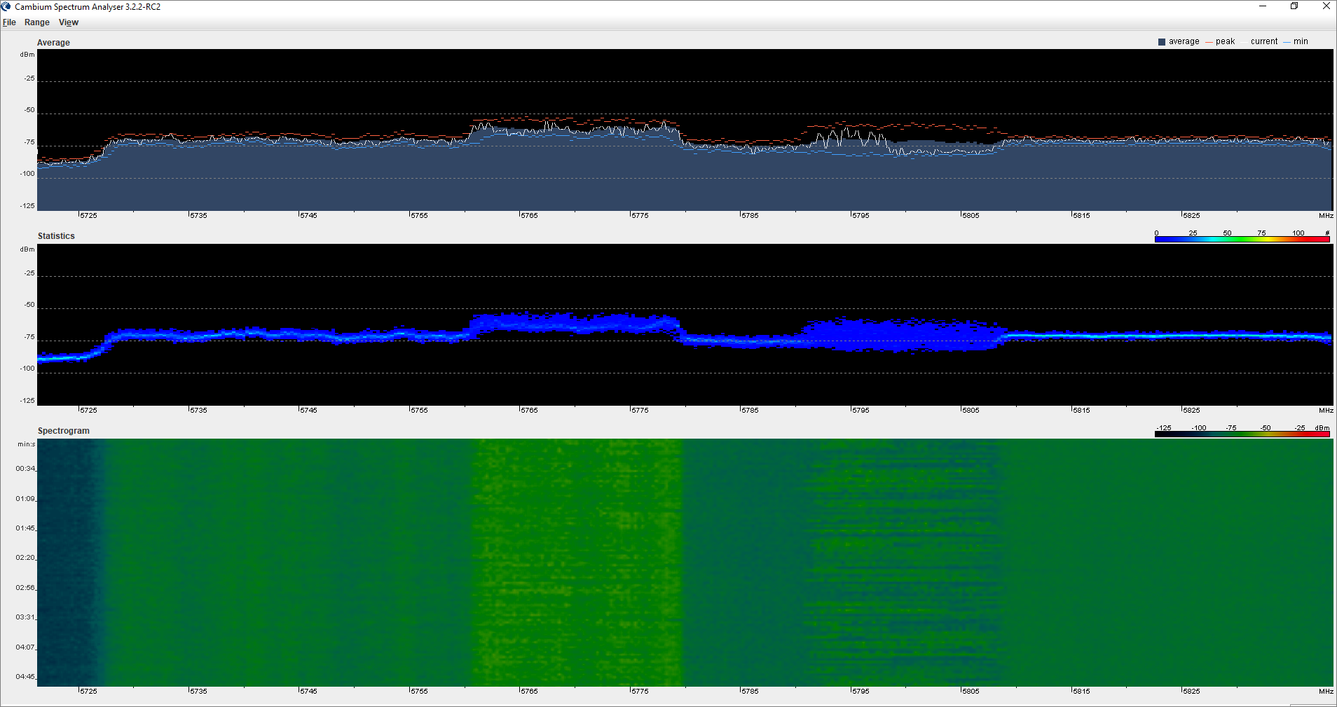

Can you share spectrum analisys as well ?
In our country (Italy), is just a nightmare
Here you go, probably worse that your area

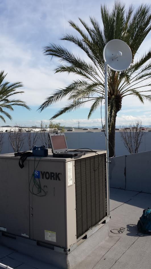

What is your setup on the customer end ? Any idea what the link looks like without the smart panel ? Are you in FCC land , what kind of power you set at ?
Really curios here. Using ePMP 2000 radio/sector without the smart panel and using Force 200s on the customer end I can only dream of a 20 mile link.  My max link with a Force 200 to a 2000 sector is just under 8 miles  with -72/-76  SNR of 22/23 and MCS of 12/12 using 5210 in FCC land so max 20dBm.  Using 5200 so only allowed 20dBm power here in FCC land but still, holy cow at 8 miles you have -49 !?
Using Force 200 on both ends for a PTP link (though using DFS freq so reduced power)  at just 11 miles I can only get -66  (though my SNR is 35 and MCS is 15/15)  so -53 at 21 miles on a sector blows my mind.

Same client, CPE side
You can't use force 200 to get 40Mb on 20 Miles, I was able to get 33x5 mbs on 13 miles PTMP link, but that's about it.

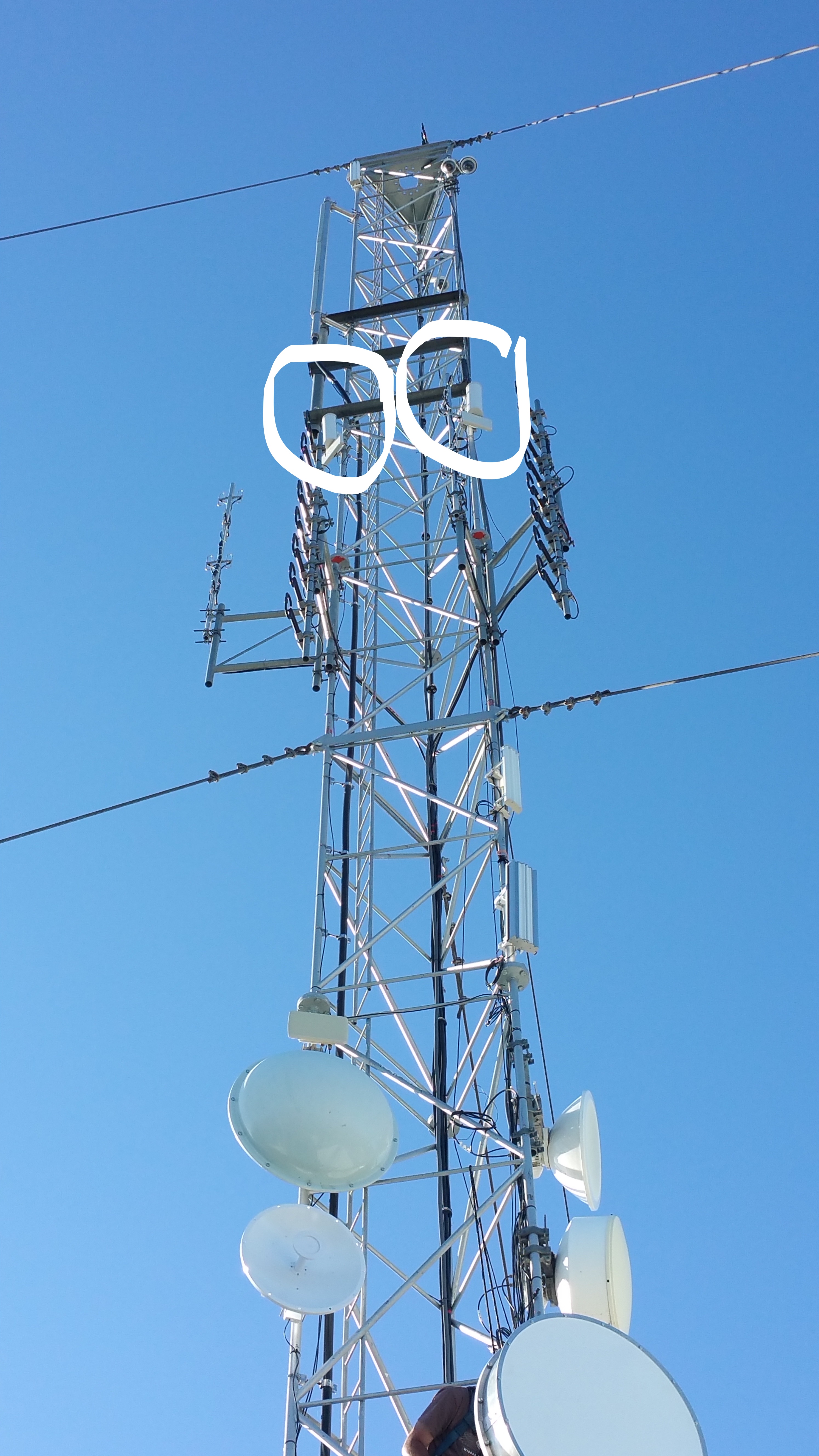

Here is the tower
you shared spectrum parts from 5720 on, but you use 5240 as main frequency.
can you share spectrum on you channel range?
