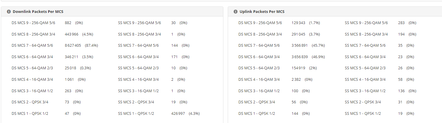

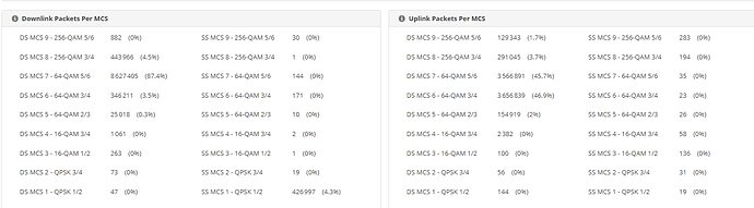

Provide pic of Monitoring > Performance > Downlink/Uplink packets per MCS section of both AP and SM in question.
Also compare that to a known good performing SM. Your target MCS should be the highest percentage, at least +50%. Be sure to reset counters at top of performance page and let run for 5 mins to get the most accurate readings.

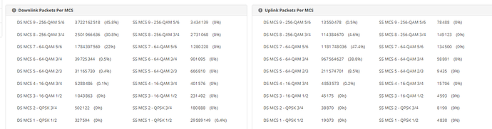

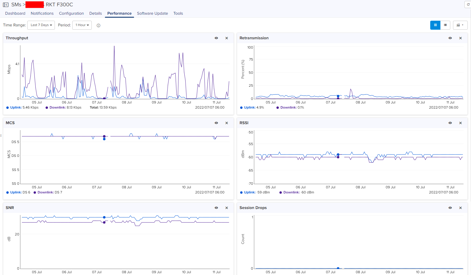

AP over last 66 days. Affected station over past 21 hours since modulation locked to MCS7

On the AP across all stations (20) retransmissions are about 1.5% on uplink and 2.3% on downlink
Retransmits on this station are high at between 3 and 8% on uplink and downlink is negligible (0.1%).
