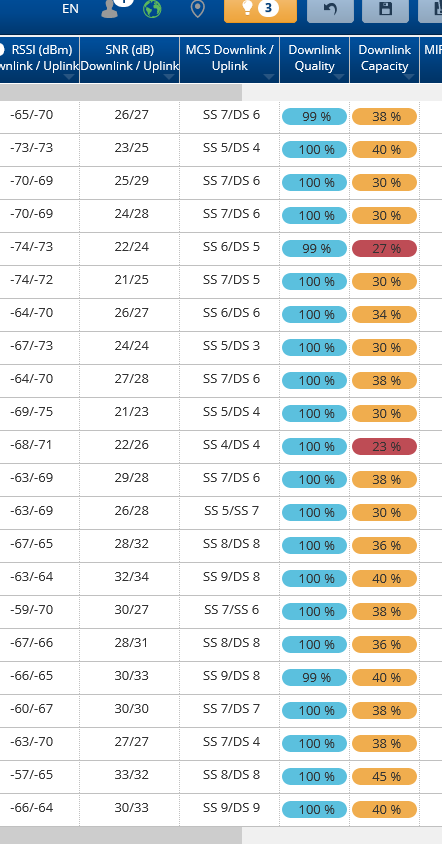

epmp4500/4500L downlink only in SS, uplink stable DS
Hi, we have some 4500 and 4500L, everything Ok for some days or weeks, but at the same moments all SMs go to download SS1 and upload remains stable DS, btest download performance, became half and seems to be no solution.
Changed frequency, PoE, flexible/70-30, gps sync, reboot, firmware upgrade 5.10.4, downgrade 5.10.1, no solution. Replacing the entire Ap, or the 4500L leaving the same antenna solve the problem.
This happened with more than 10 units, it’s possibile all this units are bad?
thanks

I have the same problem. Replaced the unit and antenna two months later history repeats. It’cant be cable problem because upload speed is fine - looks like one chain TX power is lower on AP side.
Yes one chain seems to be ko. I’ve not RF cables beacause i’m using RFE adapter with horn antenna… So the problem it’s the AP…
“Andrii, I recently had a call with Pralhad Shivmurat regarding the radio issues. After checking the system, he assured me the hardware is fine and that it’s strictly a firmware bug. He gave me the 5.11.0-RC58 firmware to fix it, but unfortunately, the situation hasn’t improved at all. I’m still getting 200 Mbps in upload, but my download is severely limited to 40 Mbps, and the radio is still stuck on SS modulations. I’m really confused about who is right here and what the actual root cause is.”
