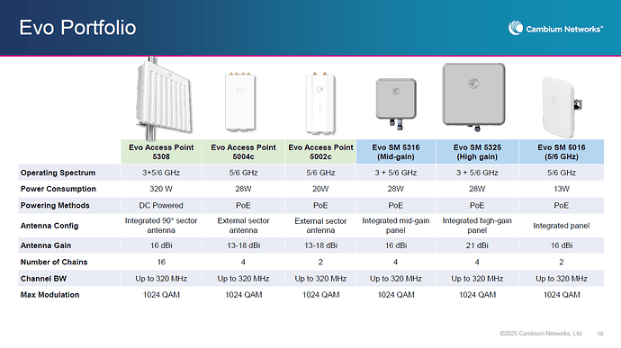

Probably a dumb question but what parts of the Evo platform was PMP and what was ePMP? Looking at former webinars and data sheets, it seems the 5/6ghz part of Evo was 802.11be, and the 3ghz CBRS was FPGA? Is that a correct interpretation?
If so then did the whole thing go to Airspan or stay with the ePMP team and if not did Airspan get the 3ghz parts and ePMP keep the 5/6ghz parts?
More likely the APs were to be based on the former 450mv concept, and the SMs were to be a mix of industrial/commercial ones based on the existing 450v SMs and lower cost ones perhaps designed by the ePMP team. I notice one of the EVO webinars involved Matt Mangriotis PLM for 450v and Antony Holmes VP Engineering for Cambium UK originally with Orthogon and now at Airspan.

Really outside of the 3+5/6ghz integrated AP the Evo AP product line looked more like ePMP than PMP.

The original goal for EVO was to use low cost 802.11be/WiFi soc for the clients with ePMP software on them. The 3GHz client radio would use an RF downconverter to support that band. On the AP side it would use an FPGA with ePMP software running on it. The AP was designed to be modular so you could add in like a 5, 6, 3, or even 2.4GHz radio modules. In terms of backwards compatibility, there were plans to port the ePMP software to run on the PMP450b and i radios. PMP450v support was dropped from the EVO equation for unknown reasons. The whole EVO platform would revolve heavily on support from the ePMP team. Towards the end, the ePMP team had produced some alpha “e5k” PtP radios for testing (I had a pair for awhile). To my knowledge the PMP450 team didn’t have any working prototypes for EVO products.
