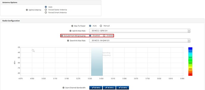

Exclude from MU grouping?
What does this feature do ?
Does it only affect downlink or it affects both downlink and uplink ?
I get way less error drops on uplink with it enabled
AP : ePMP 3000 (5.9.2)
SM : ePMP Force 300-25l (5.11.0)
Hello @Atang_Maretele,
I’m glad to hear that the feature is improving your user experience.
To clarify, this feature allows a specific subscriber to be excluded from MU-MIMO grouping in the downlink. It is intended as a fine-tuning mechanism.
There are several important considerations:
  1. When MU-MIMO is triggered, the SM loses the single-user beamforming gain. Depending on the AP chain configuration (4x4 or 8x8), this loss can be up to 6 dB, which may result in the MCS dropping by 2–3 levels.
  2. The grouping algorithm also takes into account the azimuth difference between subscribers. As a result, a given SM may be grouped with a lower-performing partner, which can reduce overall performance.
Therefore, in some cases, performance with MU-MIMO enabled may be lower than without it for a particular SM.
Thank you!
