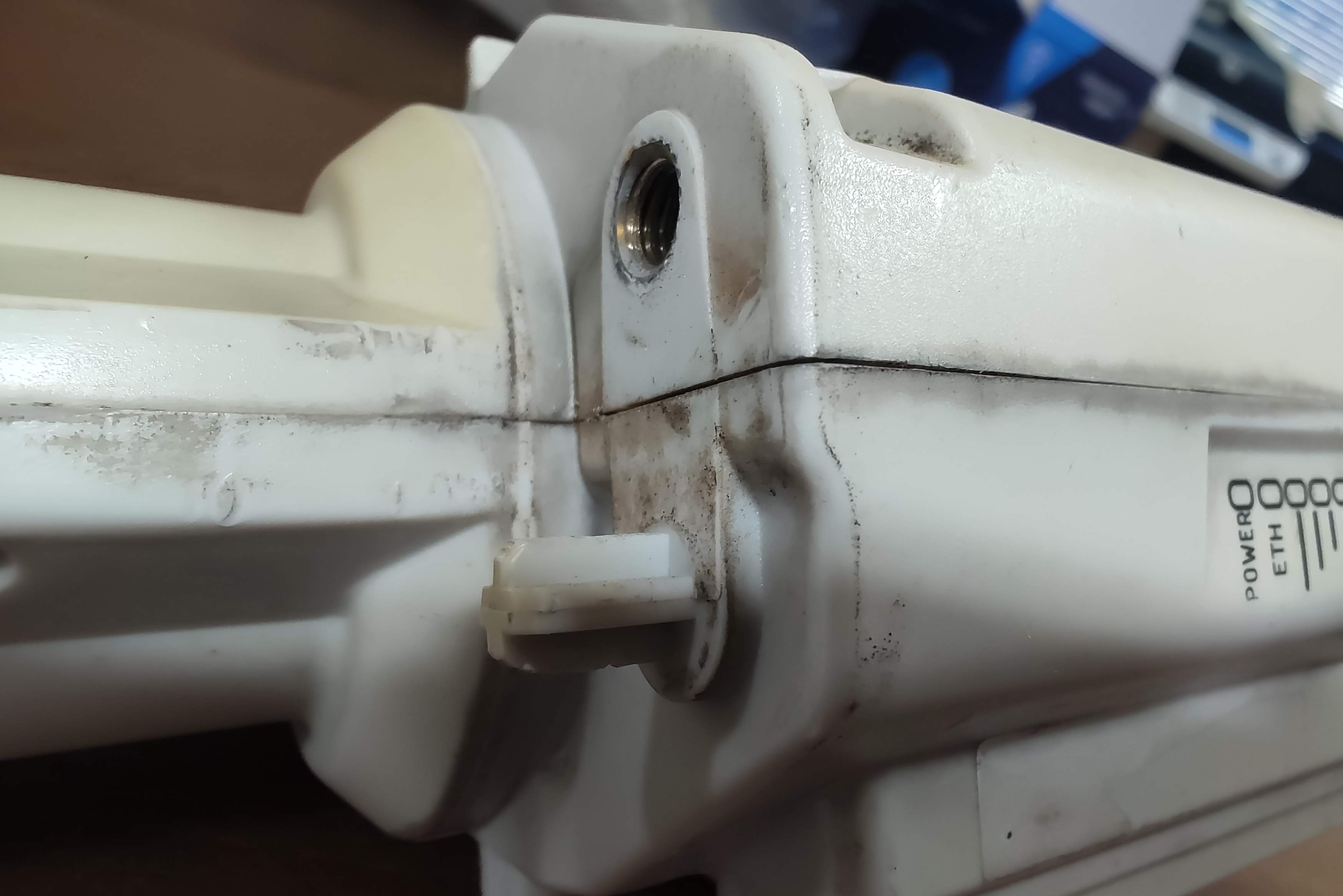

Maybe the topic got a little bit old but we have the almost the same issue still happening.
We have six units with the exact same problem: it’s getting water in the ethernet jack and it stop working. The device is still reachable by wireless but the ethertnet presents only 10Mbit connection without any communication or presents no link.
That happend with 2 links:
  • only in costumers side (briefly pointed up antenna);
  • never in our side (higher building, pointed down antenna);
  • once a year last three years;
  • always in summer period in Brazil, with more rain in our region;
Our guess it’s the water is infiltrating into the unit sides and accumulating in the back. After a year running and this issue happens we can see a slighly gap in the side joint and dark of dirt.
There is no way the water is coming throught the cable.
One of those was almost full of water when we replace it.

Some of our 300-25s have identically located gaps nearly 3/32" wide!
