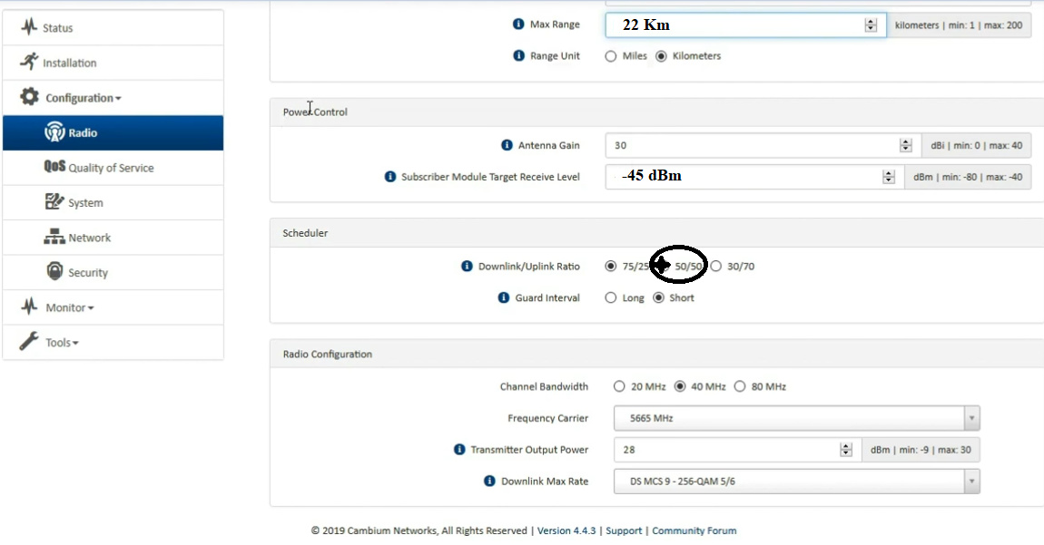

sir i need complete AP & Station side configuration help on 21 km distance
Hello Usman,
have been able to log into the radios with credentials:
Username: admin and password: admin.
If so you following these steps:
For the access point side:
Scroll down and fill in this:
Then, have a look at this video for the remaining configurations:
For the SM side, follow this video, but do recall to match the SSID on both side, channel bandwidth (40 MHz), select the SM side the configured frequency on the access point and pre-shared key:

  1. distance only matters on the AP side, set your max range to 22km (these things sometimes do not register if the max range is too close to the actual distance)
