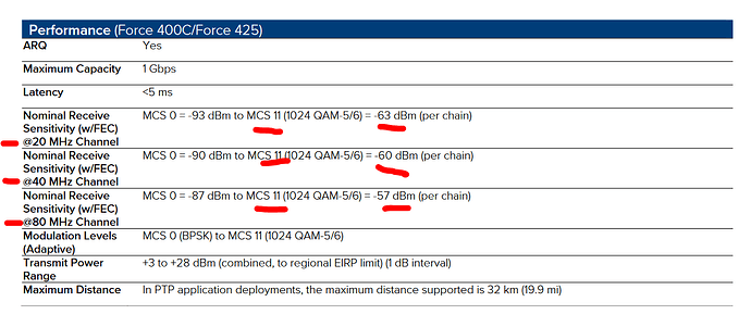

Force 400C for working at 80 MHz channel bandwidth at 1024QAM 5/6 according specification must have RSSI >= Receive Sensitivity @80 MHz >= -57 dBm. It means SNR >= 36 dB.
Also fade margin =3 dB shoud be added, so RSSI should be >=-54 dBm. It is required RSSI for 1024QAM 5/6 at 80 MHz without interference.
If real world inteference always exists and ePMP takes into account instead of SNR other parameter CINR = C/(N+I) = Carrier/( Noise + Interference). CINR is calculated by ePMP Link Adaptation mechanism on packet loss based algorithm
but is not showed, only SNR is indicated. Roughly required RSSI with interference may be calculated as RSSI>= Interference + SNR.
So if interference is I=-85 dBm, than required RSSI for 1024QAM 5/6 at 80 MHz should be RSSI => -85 interference +36 SNR +3 fade margin >= -46 dBm.
At 9 km link with dish 30 dBi we have UL/DL RSSI=-42 dBm and it works fine.
