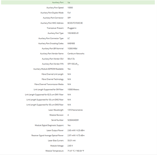

On the ePMP 4500 and 4600 fiber ports, is there a way to see the dBm signal from the switch?
Yeah, assuming you’re running a newer firmware revision, like 5.11, you can see this under Monitor → Network
Yes but these numbers seem to be the same on every radio. No variation
I checked 3 e4k radios, and the numbers are all different.

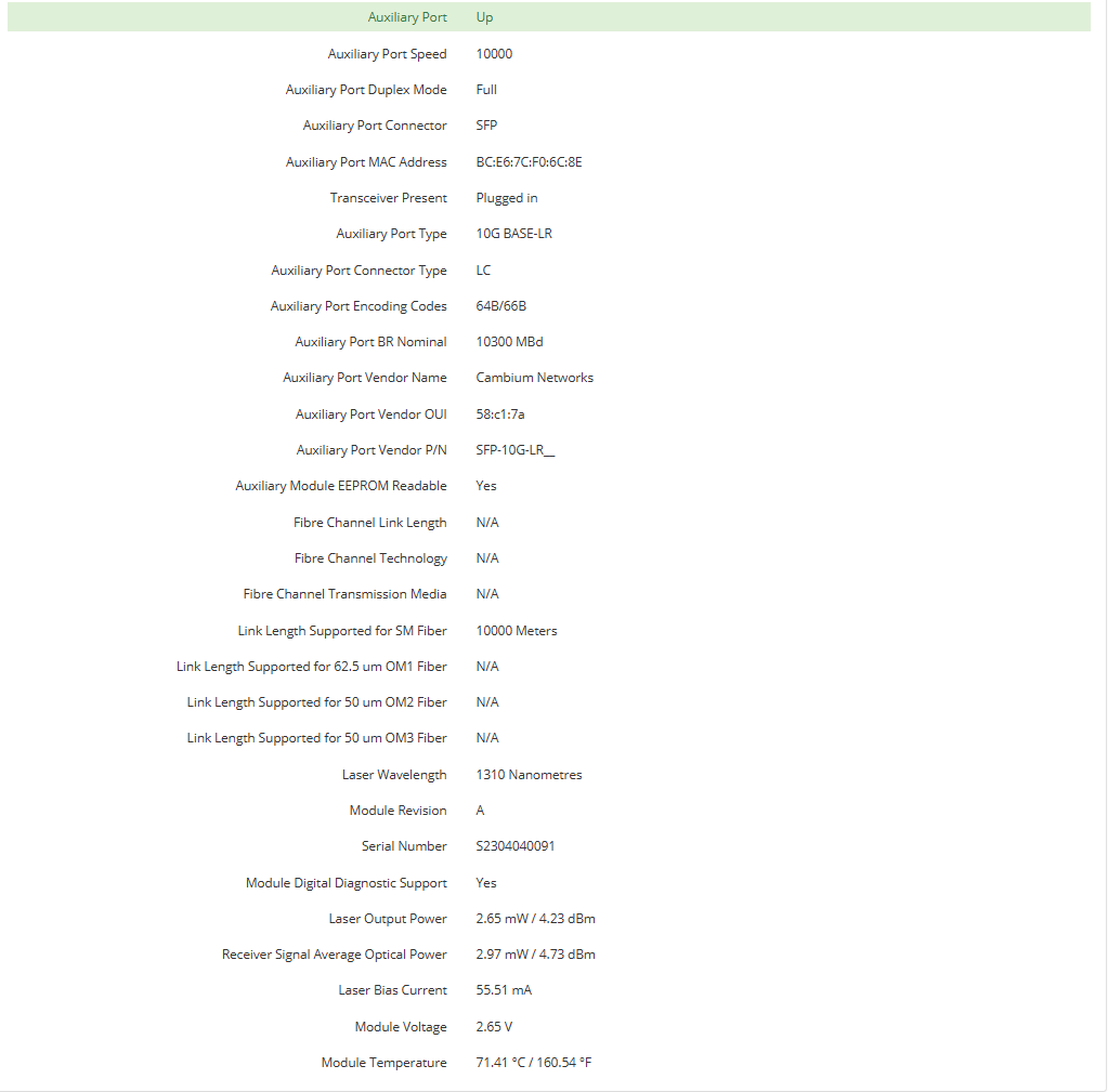

On my radios I’m seeing exactly what you have on the 3rd image. 2.65mW / 2.97mW.
What version are you running and are these 4500 or 4600?
I wonder if this is an issue with ePMP 4600?
Support, can you check if this is a bug?
I checked both e4k 5 and 6GHz AP’s. What firmware are you running?
You can file a support ticket here: https://support.cambiumnetworks.com/
A mix of firmware unfortunately. 5.10.1 as well as 5.11.1
All 4600 AP’s

Martin, what SFP modules do you use?
Thanks
cambium 10g sm units.

I can confirm the issue with the Cambium 10G SR SFP modules, and we are actively working on a fix.
The behavior appears to depend on the SFP+ module type and manufacturer.
Could you provide more details about your intended setup and what you are trying to achieve? We may be able to suggest a workaround while the issue is being addressed.
Thanks
Typical deployment is a cluster of (6) ePMP 4600 AP’s or 4500. Fiber to each radio using the Cambium SFP+ modules.
The issue we are having is diagnosing fiber problems. We have stats from the switches but can’t see stats on the radios. 1 tower specially had a bad multi-pair fiber run and it took a long time to figure out where the problem was.
