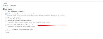

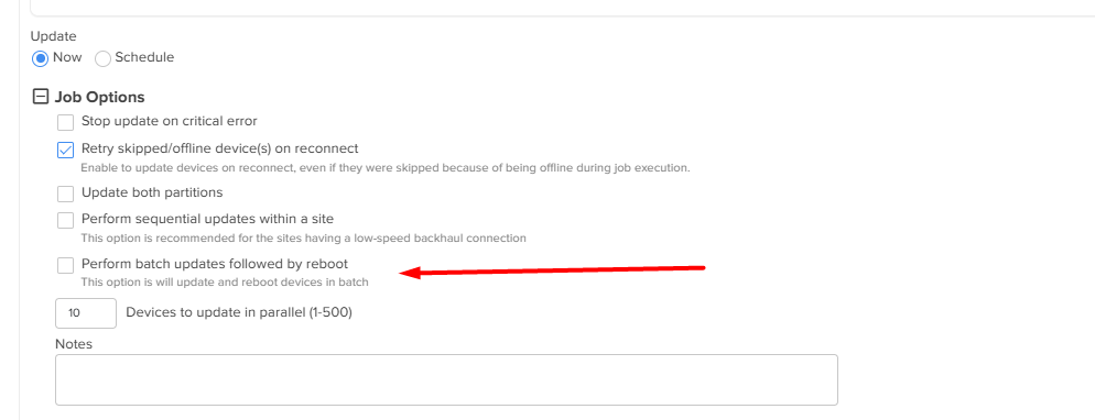

To perform batch updates and reboots - Enable “Perform batch updates followed by reboot” under Job options.
For ref:
