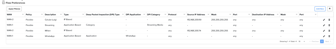

I have two broadband internet services connected to WAN1 and WAN2.
I have created two flow control rules. I have set two computers on my local network, with their respective fixed private IP addresses, to exit through WAN2.
Additionally, I have instructed the flow control to allow all WhatsApp traffic to exit through WAN1.
When I run the rules on the computers I configured for WAN2, they are no longer able to access WhatsApp. :slightly_frowning_face:
Is there a way to create these two rules so that they do not affect the WhatsApp service?

On your question about flow preferences, could you please share a screenshot of the flow control rules you’ve added?

Regarding flow control, it already worked for me.
