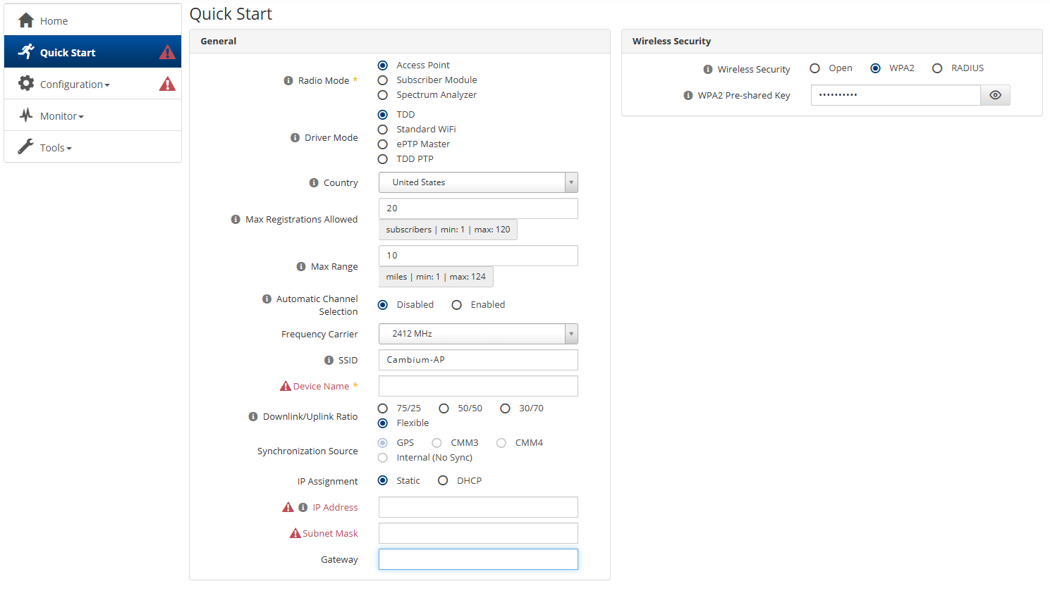

The Driver Mode, SSID, Wireless Security, Frequency channel & width should match on both AP & SM.
Try using the radios quick start configuration page. It has everything needed to get the radios to link up.

Ok, just off the cuff here…
If your AP is an Ubiquiti and your SM is a Cambium, then that’s going to mean that neither of them can be set in their default “preferred” mode, because they will be incompatible.
So, you’d have to set the both to WiFi mode in order for them to have a chance to talk to each other. The Ubiquiti AP would have to be in Wi-Fi mode, and the Cambium SM would have to be in Wi-Fi mode as well. That’s certainly not optimal, but that’s the only language they can speak together.
Then of course the AP and the SM would have to be set to the same SSID, and the encryption mode will have to be the same (open might be the easiest to experiment with at first) plus you may have to set the Ubiquiti AP to WDS mode to get the Ubiquiti AP into a bridge mode.
