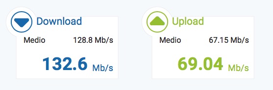

I tried 40MHz channel on 4.1.2-RC14.
It works good and seems pretty stable (I limited upload on MCS 8 so it's more stable).
UDP Performances (on MikroTik bandwidth test) looks similar to Wireless Link Test (about 210Mbps, stable), but using iperf, MikroTik Bandwidth Test or nperf or speedtest.net on TCP I can see these results:
about 130Mbps on download, not super stable, sometimes you can see 160, sometimes 120, sometimes 150... Rarely more.
65-69Mbps on upload each test, super and perfectly stable.
Why is TCP so different?
ninedd, did you find such a difference?
