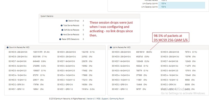

This is a few graphs and stats on a Force300 we're running as a backhaul across town. WE ARE CURRENTLY ONLY USING 20 MHZ WIDE CHANNELS ONLY - so very very impressive for only 20 Mhz of spectrum.
So, it was 3 days an 7 hours since I upgraded to Beta 4.1.1-RC6 and rebooted the link. Over those three days, we have passed about 1.4 Terabytes of data. Hopefully you can see the rest of the numbers on this screen shot - very few errors or drops or any problems, and 100% 100% quality.
This screen shot below shows that 98.5% of the packets are at the highest modulation - 256QAM. I also note that the screen show 4 session drops, but this isn't really accurate - I was still configuring and sorting out the power cables, so in the first 1/2 hour after it was aimed, I rebooted and tweaked it a few times. There have actually been 0 drops over the 3 days, 7 hours.
