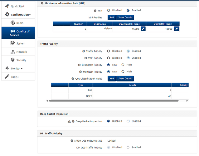

I was about to ask everything that @ninedd just said… and add that it’s typically not a good idea to limit or rate lock the modulation in order to deliver a specific service tier. You’ll want to use something at the head end, like Cambium QoE to provide shaping/rate limiting… OR just use the radio’s built in QoS rate limiter to set the SM’s MIR to 15mbps.

Tried talking to my ISP to change channel or atleast an alternate 40 or 20mhz channel on the access point and they don’t want to solve my issue of low link quality and retransmissions. decided to just limit mcs instead! im using a force 300-25l and it has ss and ds mcs
