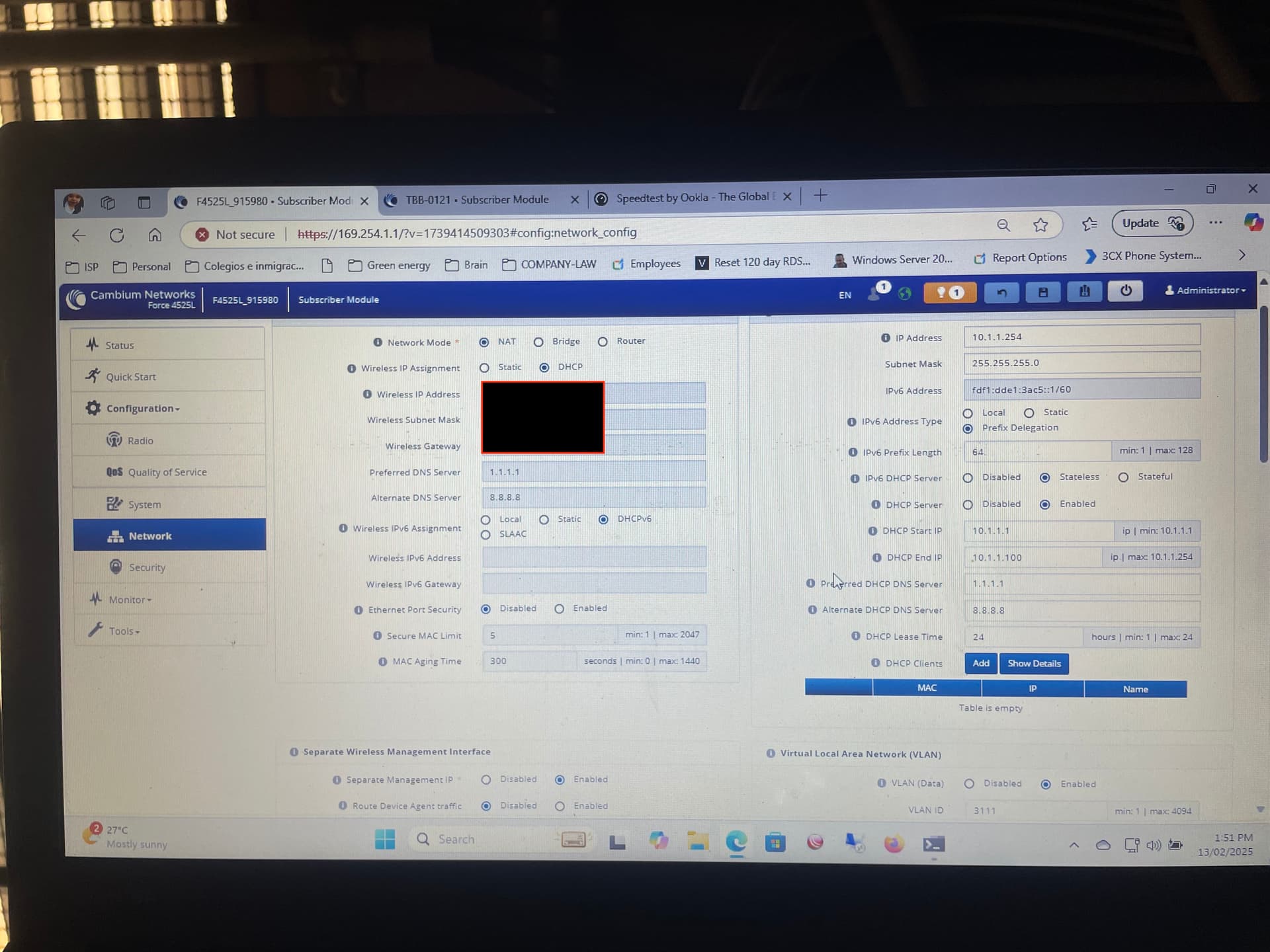

I’ve been testing this setup, 4500L as AP, force 4525L clients.
In NAT mode, the clients don’t get any ipv6. IF I connect a force 300 in NAT mode to the same AP then It gets an IPv6 address and so does my laptop behind it. If the force 4525L is in Bridge mode then my laptop gets an IPv6 address. I have tested the AP and force4525L using both 5.9.1 and 5.9.2 vers. Both F300 and F4525L have exactly the same network config.

@Fedor Hi Guys, Is there any one who could help me with this issue?, Cambium support said They needed to replicate the setup but I haven’t had any update since last week. I forgot to say that my public Vlan runs on 1700 MTU. As I said before, F300 cpe’s get Ipv6 address with no issues at all.

We have successfully replicated the issue and opened a ticket for our developers to fix it.
Expecting this to be resolved in our next releases. We will let you know when it’s ready.
