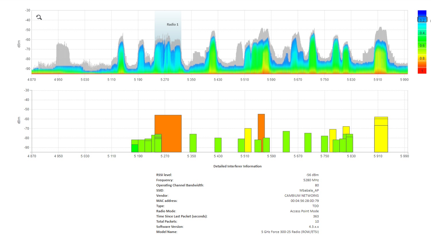

This is my result, can you please assist by telling me how to read this so i can now in future please, I'm new with cambium, and would apriciate assistance. To know how to look for the less interference.

On this one the big orange block i assume is the AP on my tower side because it says Mbabala AP and that is my AP name? Or how does it work?
Just to experiment, you may want to try going to 40 Mhz channels, and also try moving your channel up fomr 5280 to 5290 or 5300 (whatever fits' you in between those other busy channels) just to see what your Link Test results are then.
We get over 300 Mbit per second on our Force300 PTP links in 40 Mhz
Also - what does your TOOLS -> WIRELESS LINK TEST on the AP side report when you do a link test for 10 or 20 seconds? This is one of ours in 40Mhz widths, which is 315 Mbit aggregate. :)
