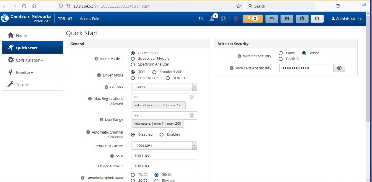

This frequency hold off issue can see on ePMP 2000,How to fix?. Pls support & Help.

Ok - well, a thing I see is GPS Sync Down.
If the AP loses GPS lock, it’ll count down the time limit you have set, and it’ll then shut down the transmitter. So, if this is what’s happening, you may just need to figure out what’s caused the gps issue.
Is this ePMP2000 outdoors, or just testing inside? Does it have it’s GPS antenna connected with a clear view to the satellites? Or, maybe you need to reconfigure the Sync so it’s not using GPS, if that’s appropriate for your needs?
Also, make sure you are using the latest Firmware - there have been GPS firmware bugs which have been fixed from time to time, so you’ll want to be sure to use a firmware with all the appropriate GPS fixes.

Thanks ninedd,Outdoor Sector is placed on the roof of the building, the height is about 65 meters.
I will test is new firmware .
OK - yes, the root cause of the ‘Hold Off’ in your case, would be because you have your Synchronization Source set to GPS, and yet the GPS can’t find/lock on the satellites. That could potentially be an issue with your GPS antenna location, it might be an older firmware issue, or it might just simply be ‘one of those things’ and the just AP needs a power cycle. BUT, whatever the reason, the GPS seems to be the culprit.
Another solution (of sorts) is to reconfigure the Synchronization Source to be ‘Internal (No Sync)’ and to save/reboot, and that should get the AP broadcasting again. Of course, after that change, it won’t be Sync’d any longer, so it might then interfere with your other nearby AP’s. But - that change would get it broadcasting again.
