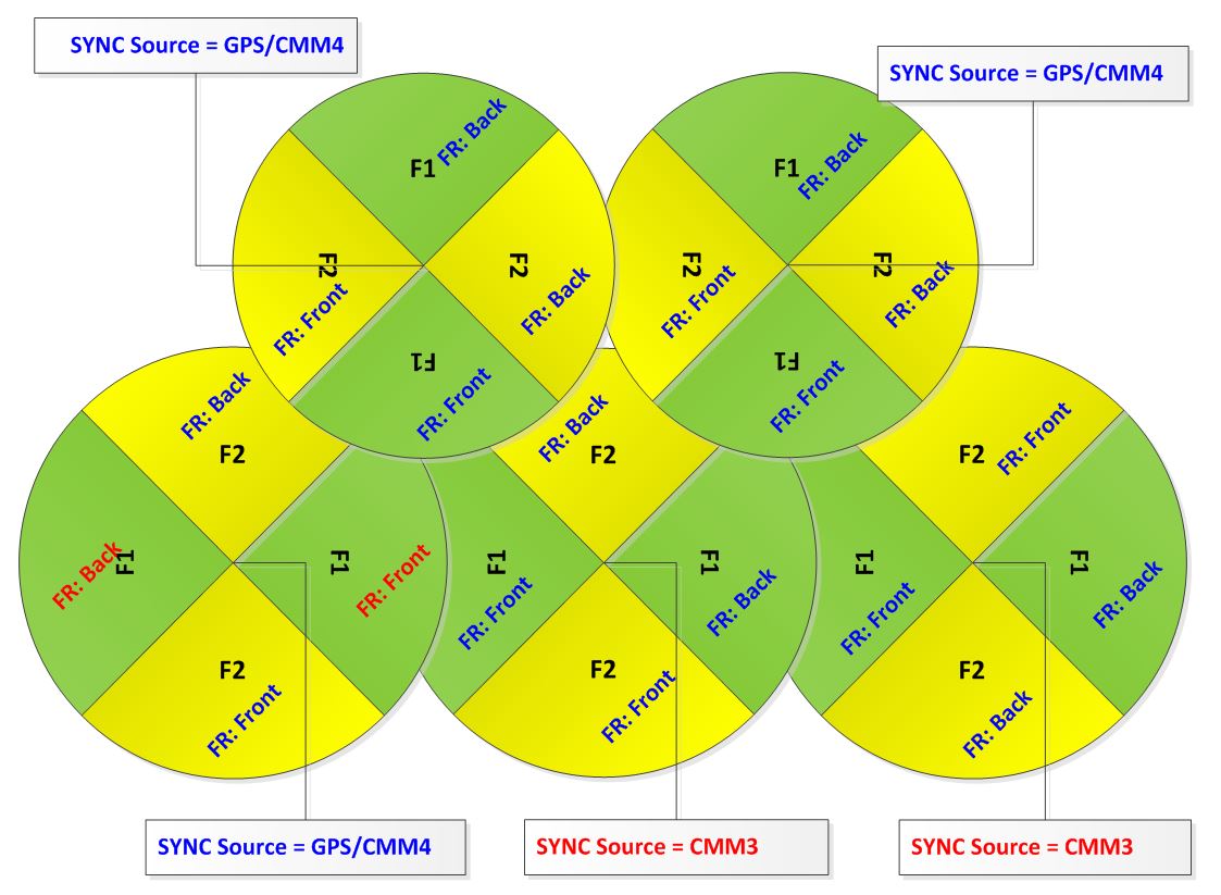

For examples of how to configure Frequency Reuse to ensure that interference is reduced throughout the deployment, see figure right.

The GPS sync source is a mixture of all types (CMM3, CMM4 & “onboard GPS”)
In this configuration the GPS sync source in the whole network is one of the following:- (CMM3 and “onboard GPS”) or
- (CMM3 and CMM4) or
- (CMM3 and CMM4 and “onboard GPS”)
For more examples of which APs to enable the Frequency Reuse feature in this mixture of sync sources, see figures right.
The rules in selecting the APs to configure Frequency Reuse to Front Sector or Back Sector in a mixture of sync sources deployments are:
- Only ONE of the APs on the same tower configured with the same frequency must have Frequency Reuse set to Back Sector if the sync source of both APs is the same or the sync is a combination of “onboard GPS” and CMM4; the other AP will be configured with Frequency Reuse set to Front Sector
- For the APs on different towers facing each other with overlapped coverage:
- If both APs have the same sync source then only ONE of them must have Frequency Reuse set to Back Sector; the other AP shall be configured with Frequency Reuse set to Front Sector
- If one AP has “onboard GPS” as sync source and the other one has CMM4 then only ONE of them must have Frequency Reuse set to Back Sector; the other AP shall have Frequency Reuse set to Front Sector
- If one AP has “onboard GPS” or CMM4 as sync source and the other one has CMM3 then:
- If the AP with CMM3 sync source has Frequency Reuse set to Back Sector, then the other AP (with “onboard GPS” or CMM4 sync source) must have the Frequency Reuse set to Back Sector
- If the AP with CMM3 sync source has Frequency Reuse set to Off, then the other AP (with “onboard GPS” or CMM4 sync source) must have Frequency Reuse set to Off.
