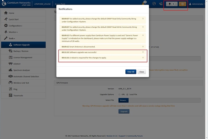

I just deployed four force 2000 devices and I decided to update the GPS firmware after I have update the device's firmware, but I after the update I lost the gps and therefore the device is not transmitting except I changed the gps to internal.
please what can I do to get my gps back.

Thanks for taking a look, it got stocked on applying and I had to power circle the device, yes I have even done a reset I had to reset the device still the GPS is not showing you can see from the screenshot, it says the firmware is up to date but its not seeing the gps at all.

I am afraid it is possible that the upgrade process may have been interrupted and the GPS chip may have ended up with a corrupted version of the firmware. The latest GPS upgrade can take up to 8 minutes. In this kind of situation, it is better to wait, refresh the browser page, and look for a notification from the device that the upgrade has completed and that the device is ready for a reboot.
