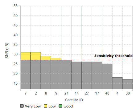

Having similar issues getting adequate signal even with new out of box GPS receivers.
We have seen similar results with the 4625 pucks. The three locations are literally grouped together at three houses. I could throw a rock and hit any of the three. We played with the puck placement for quite awhile trying every variation we could think of and this is as good as we could get them. The 4th one is about 1/4 mile away and stays in the “good” category but also varies quite a bit. We have found the 4625 GPS varies quite a bit from slightly in the green to gray, cycling back and forth
The GPS signals on the AP or 4600C are much stronger, so assuming its an issue with the pucks. Functionally they are not having any performance issues and have not dropped any links to date due to rain/snow, but assuming this is much more forgiving with the extended AFC grace period.
