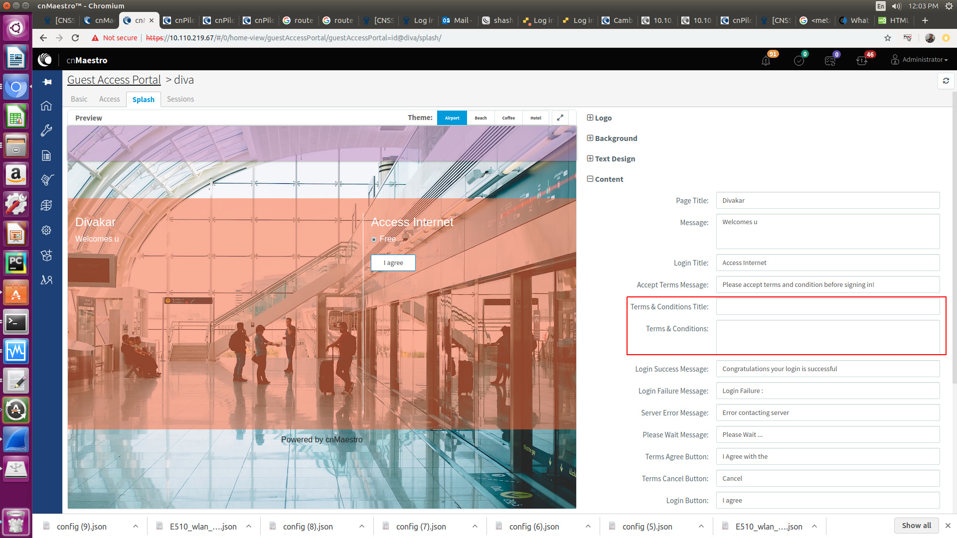

Hope you are using CnMaestro based Captive portal. Customers requested if "Terms and Conditions" is configured in the Splash page user must click the checkbox, that's why it was made mandatory before clicking "Agree" button. In older release it was not there.
As you need a basic splash page, there are two solutions to avoid this check box,

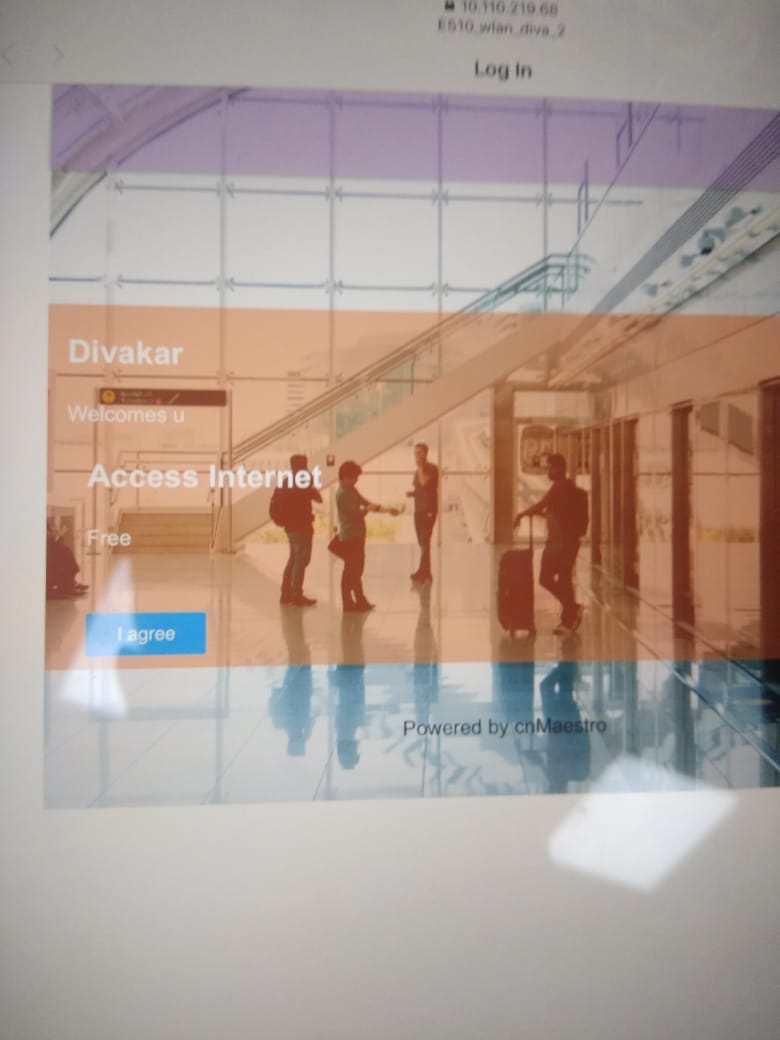

1. If you leave the "Terms and Condition" option empty, the checkbox won't come in splash page, just you need to click Agree. Attached screenshot.
2. You can use captive portal hosted on AP, with "Portal Mode"-> Internal/Clickthrough, here also just you need to click only "I Agree", there is no checkbox for "Terms and Condition". Attached screenshot.
