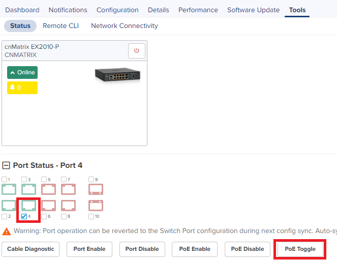

cnMaestro
  1. Login to cnMaestro and navigate to Monitor & Manage
  2. Under Networks, expand the options to locate the Switch the device is connected to
  3. Select the Tools menu item
  4. Select the tick box for the port you wish to affect and select the PoE Toggle button. This will start the process immediately. This will only work if the Switch is Online in cnMaestro.
