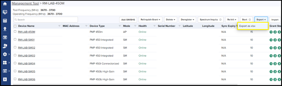

Go to Network Services>CBRS>Management tool and click on the Device name of the AP on which you would like to modify/change the parameters:
Export the Excel for this AP by clicking on the ‘Export’ option and then ‘Export as xlsx’ as shown below:
