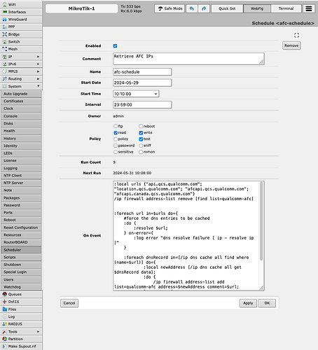

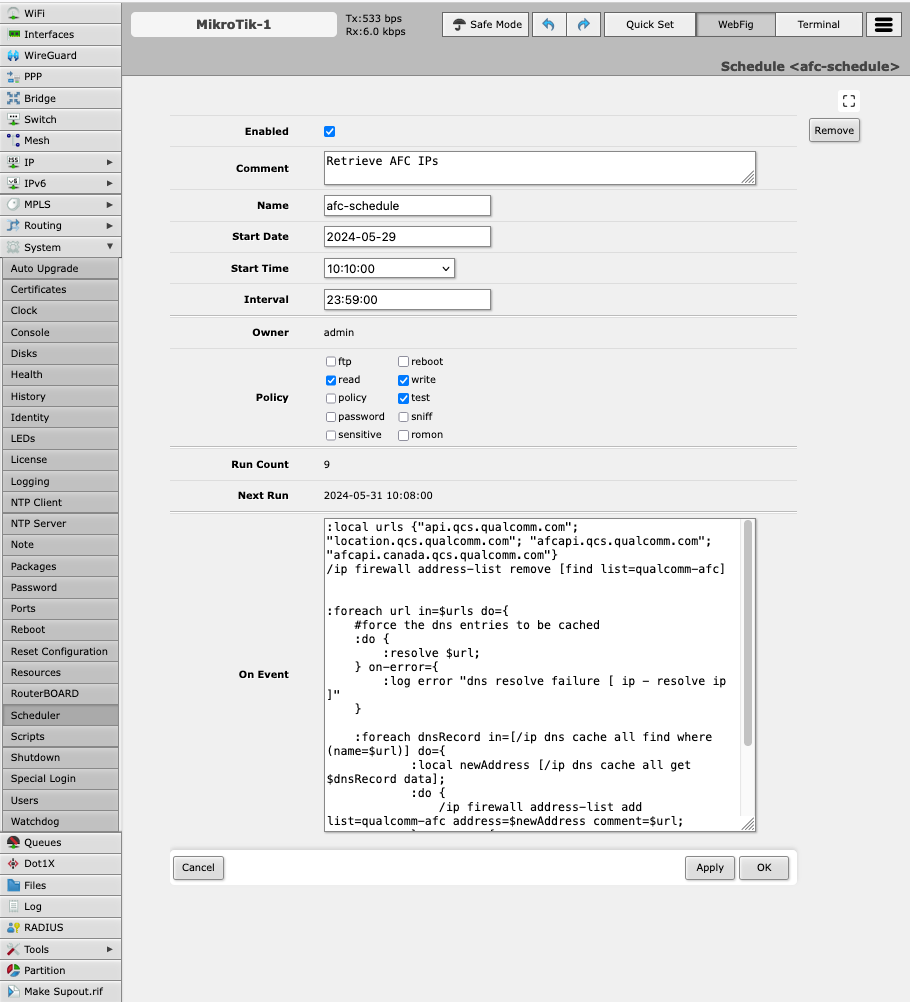

  1. On MikroTik router create new event in System - Scheduler:
:local urls {"api.qcs.qualcomm.com"; "location.qcs.qualcomm.com"; "afcapi.qcs.qualcomm.com"; "afcapi.canada.qcs.qualcomm.com"}
/ip firewall address-list remove [find list=qualcomm-afc]
:foreach url in=$urls do={
	#force the dns entries to be cached
	:do {
    	:resolve $url;
	} on-error={
    	:log error "dns resolve failure [ ip - resolve ip ]"
	:foreach dnsRecord in=[/ip dns cache all find where (name=$url)] do={
        	:local newAddress [/ip dns cache all get $dnsRecord data];
        	:do {
            	/ip firewall address-list add list=qualcomm-afc address=$newAddress comment=$url;
        	} on-error={
            	:log error "error when adding ip to list: $newAddress"
  1. Create new Firewall rule to allow traffic from your network to IP addresses in list “qualcomm-afc”:
/ip firewall filter add chain=forward action=accept protocol=tcp dst-port=443 dst-address-list=qualcomm-afc comment="Allow traffic to AFC IPs"
