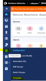

  • Once you login into cnMaestro, on your screen-left side menu, you would see the listed options: Select Configuration > Click on Templates.

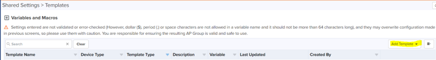

  • You will see an option on your right middle to Add Template > Then select the product line.

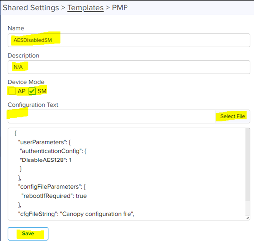

  • Provide a name for this template, the description can refer to the config or any, select device mode it can be both or anyone, Configuration text file/Enter a Valid JSON- rather than uploading a text note or just pasting the comments to the JSON column anything would work. Once you finish modifying the changes save the template.

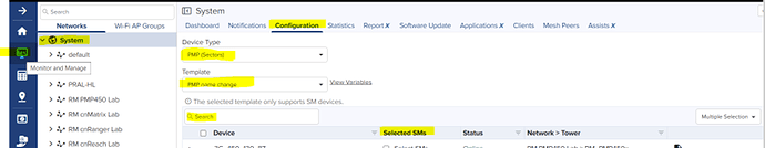

Step 2: We can push it in bulk or a single device, for bulk click on Monitor and Manage > System > Configuration > Select the Device Type, Template gives you a drop-down to see the saved templates. For single devices search for the device name or Mac and select the device and click on the configuration:

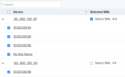

Step 3: If the config needs to push only to the AP just select the Device and uncheck the SMs listed below the Down arrow key . If need all or selected SMs you can unselect/select the required SMs.
