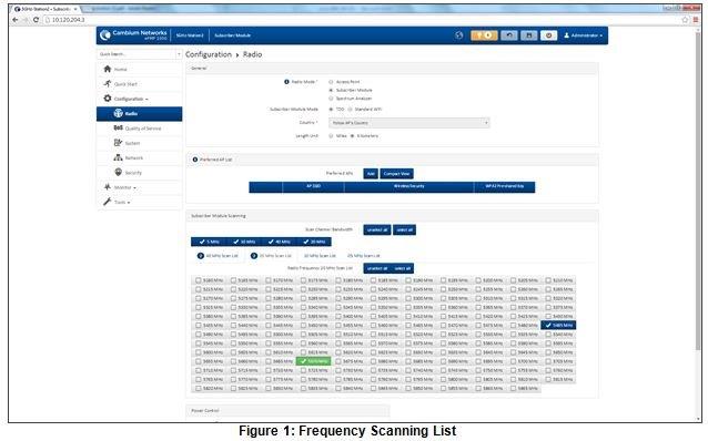

The ePMP SM needs to be able to “see” the desired AP during the scanning procedure for it to initiate registration. ePMP SMs will display the system information for all APs that it can detect during the scanning procedure at the “Available APs” table, at the bottom of the “Wireless” page under “Monitor”. If the desired AP is not listed in this table, the ePMP SM is not detecting the AP during scanning and it will not be able to register with it. In this case, verify the following:
- The ePMP SM is configured to scan only a specific set of frequencies that include the operational frequency of the desired AP.
- If there are no frequencies with the checkbox selected at the “Radio” page under “Configuration”, the ePMP SM will scan all frequencies listed.
- If one or more frequencies have the checkbox selected, the ePMP SM will only scan those frequencies.
- Notice that the frequency scan lists for 5MHz, 10MHz, 20MHz and 40MHz channel bandwidths are separated. Make sure to look at the frequency scan list of interest based on the channel bandwidth.
- Ensure that the operational frequency for the desired AP is selected.
- If unsure of the operational frequency for the desired AP, unselect all frequencies.
NOTE: This configuration may impact the duration of the network entry procedure as all supported frequencies will be scanned by the ePMP SM. Once the operational frequency of the desired AP is known, the specific frequency can then be selected from the list of frequencies.
- Select the “Save Changes” button in the top right corner of the device GUI, to apply your changes.
- The ePMP SM is configured with the same channel bandwidth as the desired AP.
- A mismatch of the channel bandwidth configuration between the ePMP SM and the desired AP will prevent the SM to detect the AP.
- At the “Radio” page under “Configuration”, ensure that the selected channel bandwidth in the “Scan Channel Bandwidth” parameter matches the configuration of the desired AP.
- If unsure about the channel bandwidth configuration for the desired AP, select the “20/40 MHz” option which will allow the ePMP SM to scan both 20MHz and 40MHz channels.
NOTE: This configuration may impact the duration of the network entry procedure as all supported frequencies will be scanned by the ePMP SM. Once channel bandwidth of the desired AP is known, the specific channel bandwidth can then be selected from the list of frequencies.

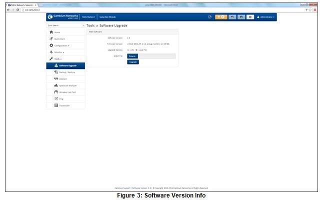

- The ePMP SM is running a software version compatible with the desired AP software version.
- In some cases, incompatible software versions will prevent ePMP SMs to successfully connect to an AP.
- Software version running on the ePMP device can be found in the “Software Upgrade” page under “Tools” or in the “System Status” page under “MONITOR”.
- If syslog is configured to display all messaging (configurable from the “System” page under “Configuration”) on the ePMP SM, an entry indicating that the SM has disassociated from the AP with the reason “SW VERSION INCOMPATIBILITY” will be logged.

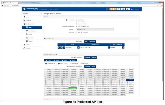

- The desired AP’s SSID has been correctly entered in the “Preferred AP List” table at the “Radio” page under “Configuration”.
- An incorrectly provisioned SSID for the desired AP will prevent the SM from successfully connecting to the AP.
- Verify and, if needed, re-enter the SSID in the “Preferred AP List” table for the desired AP. Select the “Save Changes” button in the top right corner of the device GUI to apply your changes.
- A Pre-shared key has been provisioned for the desired AP in the “Preferred AP List” table at the “Radio” page under “Configuration”, if the “Wireless Security” for the desired AP is “WPA-PSK”.
- If no pre-shared key is provisioned for an AP whose “Wireless Security” is “WPA-PSK”, the SM will not be allowed to connect.

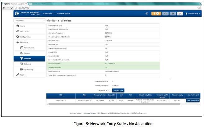

- “Network Entry State” in the ePMP SM’s “Available APs” table shows as “Unknown”.
- Provision the pre-shared key in the “Preferred AP List” table and select the “Save Changes” button in the top right corner of the device GUI to apply your changes.
- The provisioned Pre-shared key is correct for the desired AP.
- If the provisioned Pre-shared key for the desired AP is incorrect, the SM will not be allowed to connect.
- “Network Entry State”, in “Available APs” table, in the ePMP SM shows “Rejected – Invalid Wireless Security key” error.
- If syslog is configured to display all messaging (configurable from the “System” page under “Configuration”) on the desired AP, an entry will be logged for the ePMP SM containing its MAC address, association identifier (aid) and the reason “INVALID SECURITY KEY” for its disassociation.
- If syslog is configured to display all messaging (configurable from the “System” page under “Configuration”) on the ePMP SM, an entry indicating that the SM has disassociated from the AP with the reason “INVALID SECURITY KEY” will be logged.
- Ensure the Pre-share key matches the desired AP’s and, if needed, re-provision the pre-shared key in the “Preferred AP List” table. Select the “Save Changes” button in the top right corner of the device GUI to apply your changes.
