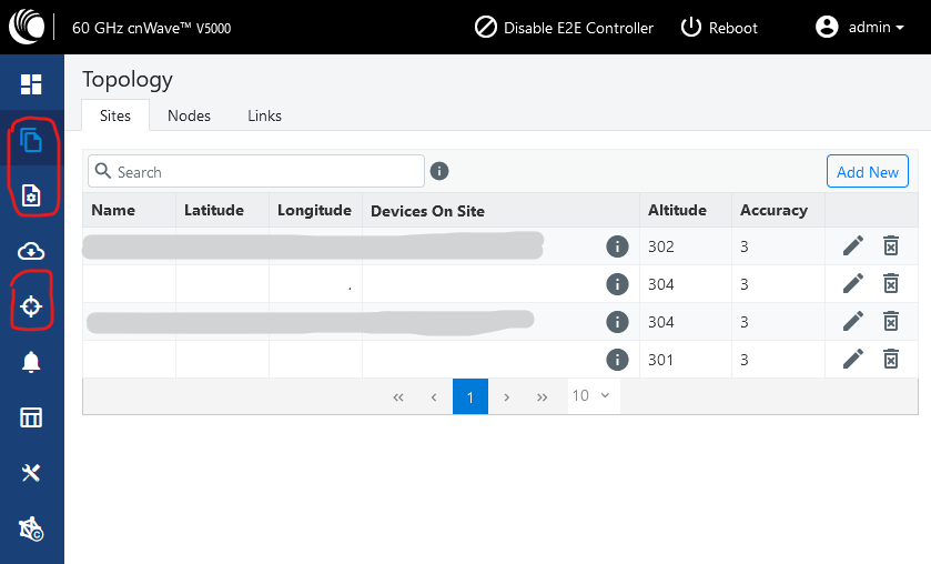

I do recognize the intent with cnWave is to make changes within cnMaestro. I do like being able to check the onboard E2E controller directly by logging into the radio.
With the External E2E controller, I haven’t figured out how to enable direct login. Is there currently a way to enable logging into the External E2E controller directly to view the primary E2E menus as shown below in an onboard E2E controller?
