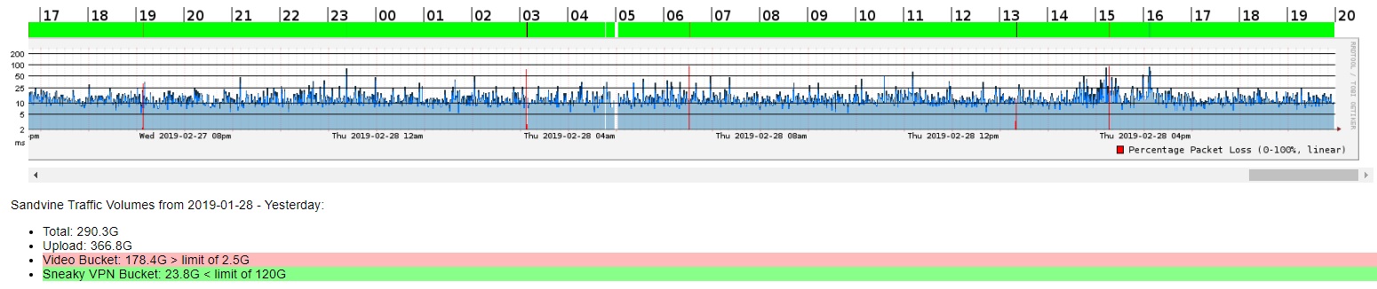

As far as IOT stuff is concerned.... Ehhhh not really seeing any game stoppers... and on top of it the gas company just deployed 900MHz smart meters to every home in my city. My PTP450i 900MHz is still working great, although it's taken a hit... the aggregate throughput is now 50mbps instead of 80mbps. I think I might be in the minority however as many WISP's have reported their 900MHz systems being completely destroyed by smart meters, SCADA, etc. as a utility updated their systems. Some have found ways to work with or around the utility deployment.
Here's a chart of my latency during the last 24+ hours:
You can see there are a few very tiny red slivers... these are some dropped packets... but they don't effect my service in any noticeable way, and I even had a bunch of people over all weekend to play Dota 2 and the connection only dropped once... that being said there's a bunch of links in the chain to get service to my house, so could have been anything.
