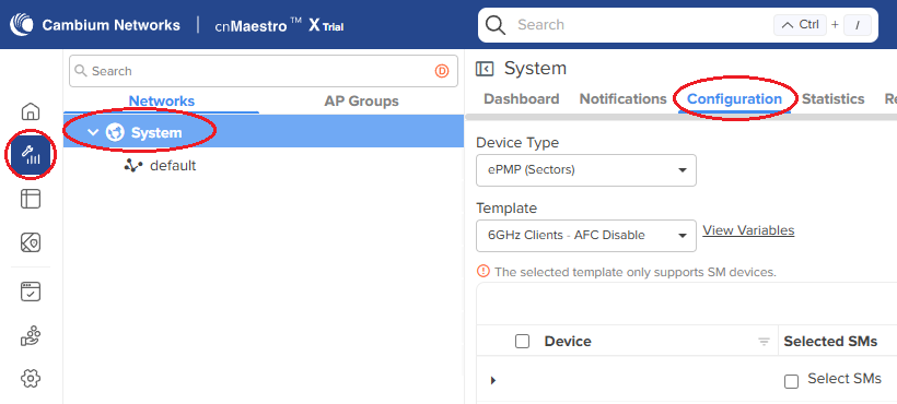

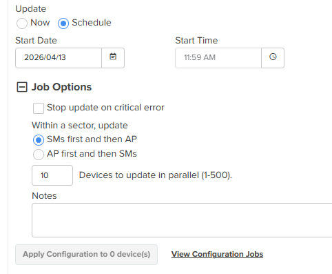

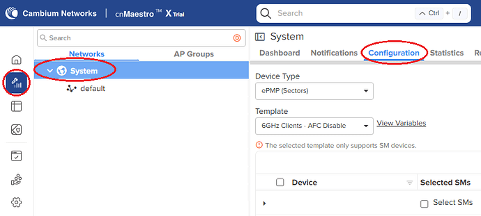

Is it possible to schedule a configuration change (using templates) on 4625 SMs, using the current version of cnMaestro (free version, cloud)?
Yes, it is. On the left side nav bar click monitor and manage, then select system or the top most network name, then click configuration, then select the device type (ePMP) and select your template. Then choose the AP’s and/or SM’s you’d like to apply the template to. At the bottom select schedule and choose the date and time you’d like to schedule the update.
