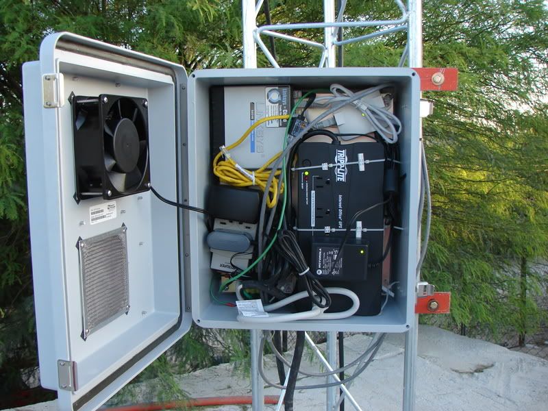

We have been wondering about best practices to keep our power supplies switches and UPS as cool as possible inside outdoor, fan ventilated NEMA boxes.
Temperatures in northwestern Mexico easily reach 45c (113f) during summertime, just like Arizona, we are located down the border.
These fiber glass boxes isolate heat much better than metal and the fan kicks in at 22c (72f)
We looked at some refrigerated boxes but they where prohibitively expensive (and large) and have to settle for these $300 boxes.
Here are some pictures. Thanks in advance for the help!

I would discourage the use of a cheap refrigerator. It is not designed for this application and will expire quickly. Once it fails, the gear inside will bake until it too fails (UPS will go first). Murphy’s Law says it will be on the hottest day of the summer.
The problem I see with your current cabinet is:
A: Too small for the amount of gear stuffed inside
B: There is no heat shield so the cabinet is absorbing all the UV
C: Consumer equipment not designed for harsh environments
A passive solution is to find or make an enclosure that your enclosure can fit inside with 2" additional space on all sides. Stand the internal cabinet off the back wall of the outer cabinet.
Paint the outer cabinet with reflective paint (same stuff they paint roofs with). It will reflect up to 50% of the sunlight before it ever hits the outer cabinet. The gap will keep the inside cabinet close to ambient which should be OK unless your ambient gets to 120 in which case the little Wal-Mart refer isn’t going to survive anyway.
Create a vent at the top and bottom so the fan in the inside cabinet has somewhere to vent to.
FYI, that TrippLite UPS is not designed to operate in extreme environments (104F max). Test often and check for leakage.
