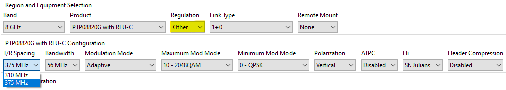

  • Added 375 MHz T/R Spacing for PTP 820G with RFU-C under the 8 GHz band and “Other” regulation.
To use 375 MHz T/R Spacing for PTP820G with RFU-C in 8 GHz band, select “Other” Regulation and then select the 375 MHz T/R Spacing option. Bandwidth options available are 7, 14, 28 and 56 MHz.

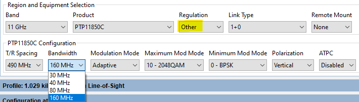

  • Added 160 MHz bandwidth for PTP 850C under “Other” regulation.
To use 160 MHz bandwidth for PTP 850C in 11 GHz and 18 GHz band, select “Other” Regulation.
