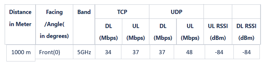

Well I’m going to use 5GHz 40MHz channel width. I want an estimate distance, without physical interference. For now, there’s no regulatory limitations. In Cambium networks datasheet says 3KM for mesh, but I think that’s no real or is it? Assuming that the regular coverage for this radios is 200 meters in my experience.

Key Performance Matrices to remember when deploying multi-hop:
Every hop in mesh reduces performance by half.
If you are using same band radio for wireless stations and mesh, latency of network increases.
Recommendations:
Use one radio for mesh link and other radio for wireless stations.
Please ensure you have RSSI of -70dBm between devices for better performance.
