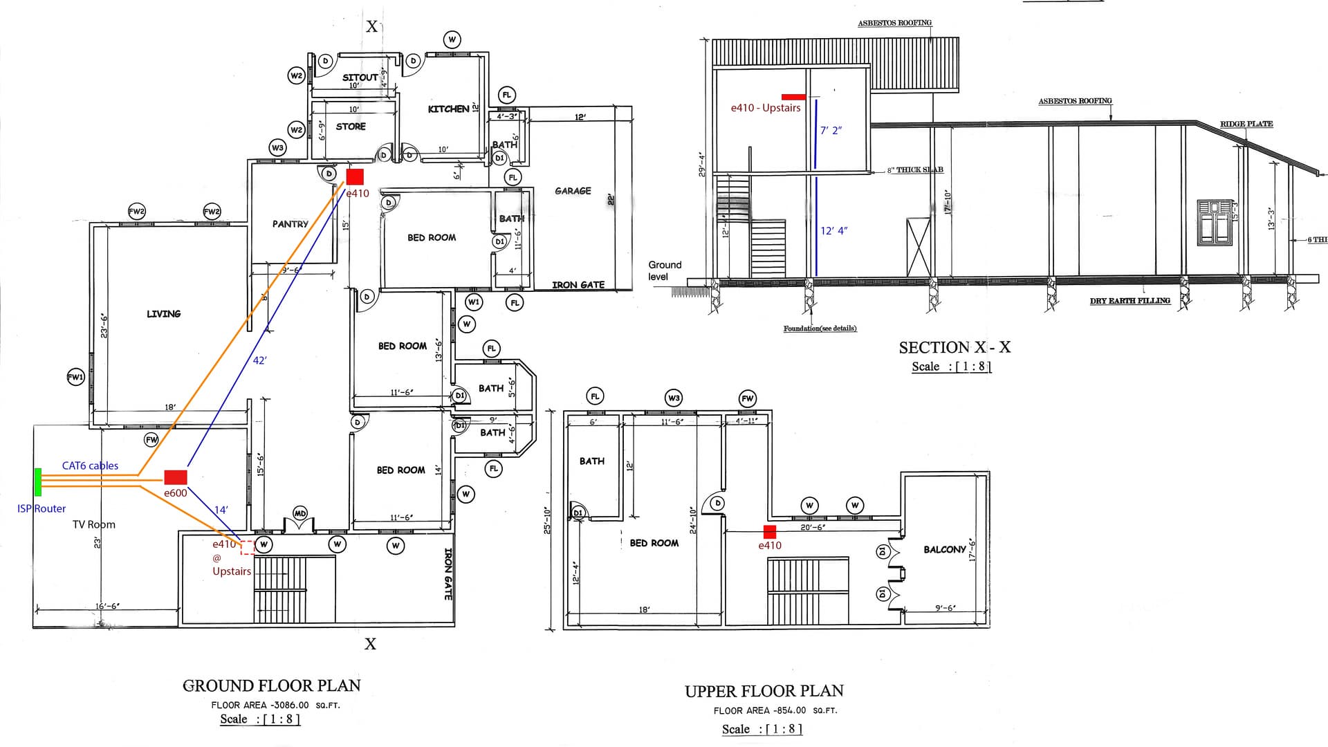

Thank you so much Gorrela. Sorry for the delay in my reply. I record measurements and marked all in a copy of the house plan (attached herewith). Please make note that the normal wall thickness is 12 inches downstairs.
my e600 and both e410 are connected to the ISP-provided router with CAT6 cables. This router has gigabit ethernet ports. All 3 devices are ceiling mounted.
Currently, I have connected all three Cambiums to cnMaestro and created the same SSID in each device.
That’s all that I have done so far. I saw the “Enable active disconnection of clients with weak signal” option in the Radio menu item and the ability to switch on the “Mesh” with Client/Bass/Recovery options in the WLAN menu item. I kept them unchanged in the defaults as I could not find them in the settings of the cnMaestro.
Hope you will help me set up my devices and to optimise the performances.
Thank you once again.
Thank you for replying. Me and my team will get back to you as soon as possible with best solution.
But a small confusion here, at starting you have mentioned e400 but in the latest reply it was mentioned e410. If you could tell me which one exactly it will be very helpful.
Because the e400 has different performance than e600 which is slightly odd combination and e410 device is just as same as e600 which is much better combination.
Dear Gorrela,
Sorry for the confusion. My reseller gave a quotation for one e600 and 2 e400 at first. But I was delivered 2 e410 with one e600 !
So, I end up with e410 model.
Thak you
Thank you for the update, will get back to you soon with Suitable solution.
